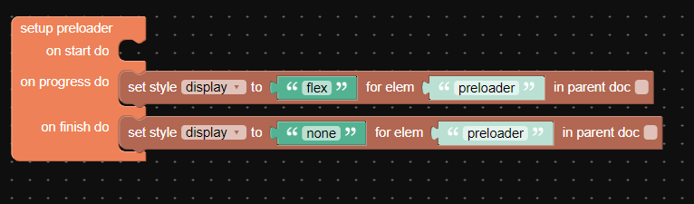

2023-02-27 at 1:59 pm #60726xyn333
ParticipantHI. @Brian I had the same issue as everyone above, through desperation I had to solve it, FAST!.
Here is the solutions.
Step 1, Make sure the
<div id="preloader"></div>is inside the v3d-container div.Step 2, build this init puzzle shown in the attached screenshot
Make sure, NOT to set on start, and uncheck in parent document. These were holding it back, as this would work, if you built the page to consider outside preloaders, however, if the preloader is built in the v3d html template, it will revert and be interrupted by various other head or footer scripts from wp / divi / elementor etc etc.
Keep it inside v3d as much as possible, and it creates less scenarios and complexities.

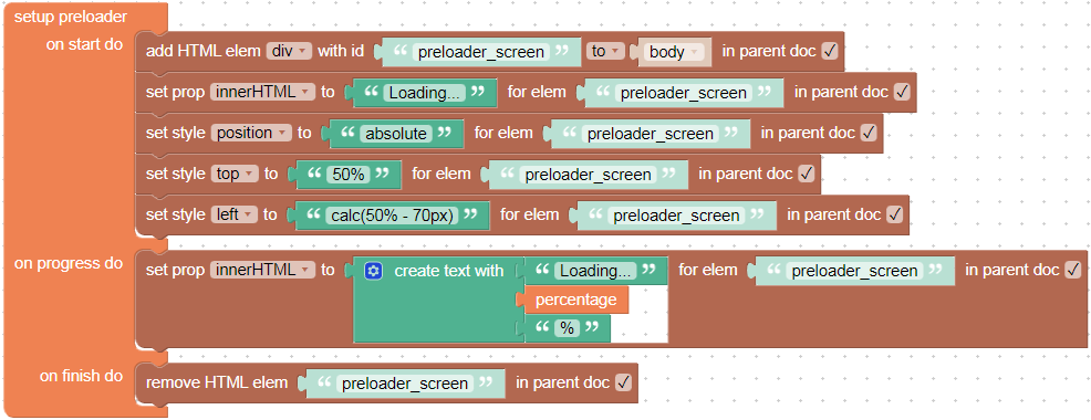

2023-02-28 at 1:23 am #60736kdv
ParticipantNOT to set on start,
I wonder why? ))) This slot is supposeed to show/create the preloader sreen. The second slot is supposed to show some changing information during loading. The last slot is supposed to hide (or remove) the preloader screen.
An example of the simplest universal custom preloader. The preloader screen will be created in a parent document (ex.
index.html) if this parent exists. Otherwise the preloader will be created inyour_app.html.
In general there are only two mistakes:
1. The preloader div is located inindex.html(the app is embedded in an iframe) but the optionin parent docis disabled. In this case JS script can’t find the preloader div inyour_app.html. Why? Because it’s inindex.html(in its parent document).
2. Using cross-origin iframes (index.htmlis on one domain, the app itself is loaded somewhere else, ex.v3d.net). In this casevisual_logic.jswill be blocked if it try to change something inindex.html(ex. changing a preloader visibility).Puzzles and JS coding. Fast and expensive.
