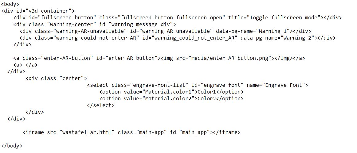

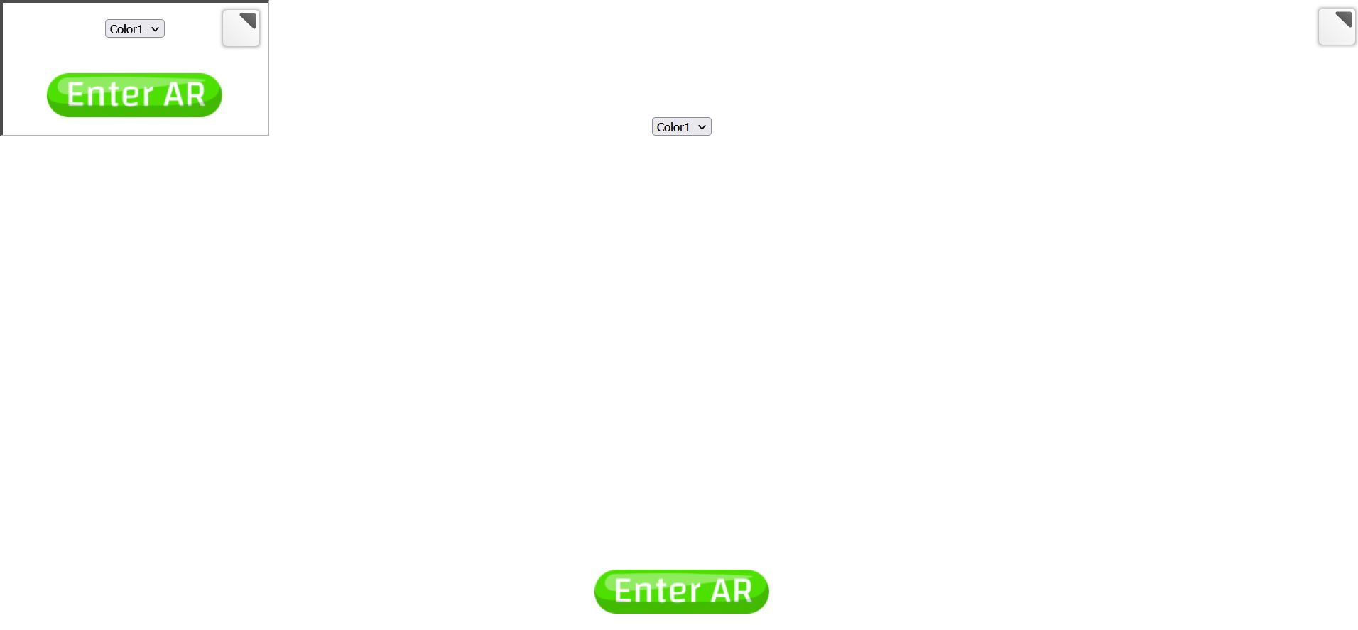

    While loading my app, it seems its loads 2 times.
    One time in the top-left corner.
    A second time in the correct way, full screen.
    It ends with only the correct way, full screen. Correct.
    But why loads the top-left corner also in the beginning?
    It looks like something is conflicting with the container and the iframe. But I is it not loading in full screen only first time?

    But why did you add an iframe? What for? This iframe loads wastafel_ar.html inside wastafel_ar.html and shows it at the default position (left-top corner)…
    Yes, your app is loaded 2 times.
    #66033
    vision
    Ah great, it works when removing the iframe line. It was a leftover from the copy from jewelry-app.
