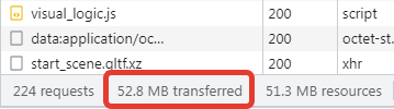

    I’ve noticed that apps loaded to some hosting are loaded faster than on the local server. Verge3D local server transfers some data in large quantities.
    soft8soft.com
    localhost
    My app with multiple texture replace requests loads much faster from cdn.soft8soft.com :scratch:
