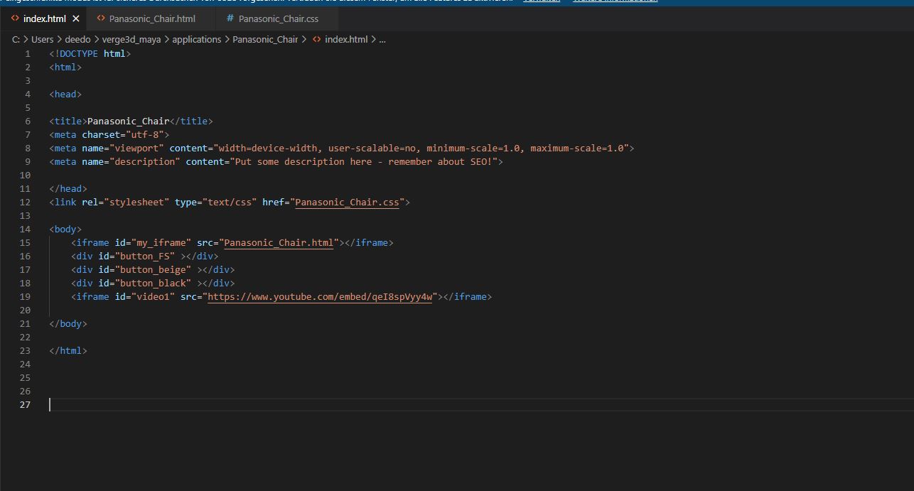

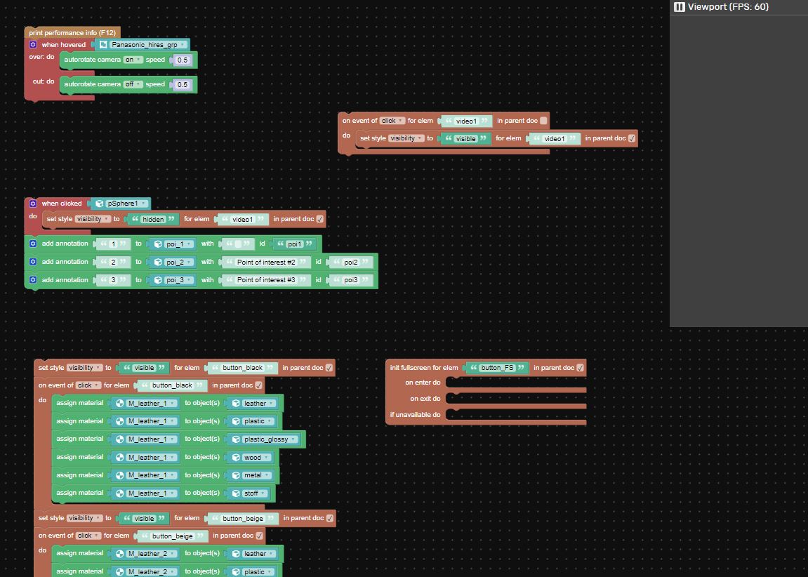

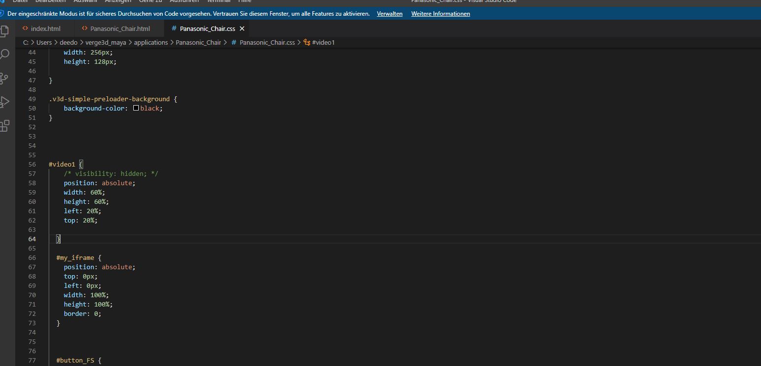

    Hi, I have troubles with reproducing of what I already had..
    Basically, I want a video to popup in an iframe when I click on an annotation.
    Like in this older example..
    https://cdn.soft8soft.com/AROAJSY2GOEHMOFUVPIOE:731bbef0ca/applications/Panasonic_Chair/index.html
    I had troubles on iPhones with this because the video iframe always automatically popup on initialization.
    The new HTML, CSS and verge code looks like in the pics I attached.
    I hope someone can help. Thanks

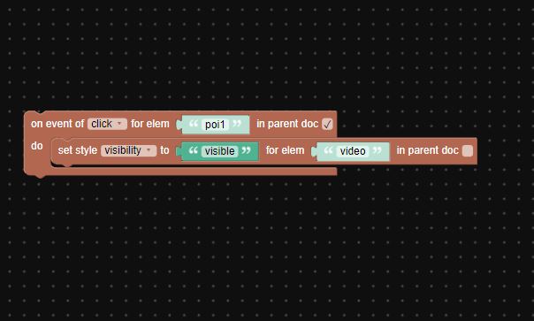

    #47497
    deedox
    Hi Haris, but why is it a problem to use an iframe? The code is very simple and it worked already but I can’t reproduce it..
    For some reason the event click wont work.. Without it iframe with the video loads just fine..
    #47511
    haris
    Deedox Can you share the source file?
    #47518
    deedox
    Hi Haris, thanky you. I sent you an e-mail
