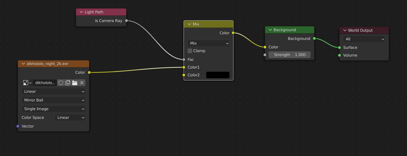

    But where is this Mix RGB Node?
    See the attached image, I have only this in my “world”.
    Pekka
    #50124
    It’s in the middle of the screenshot.

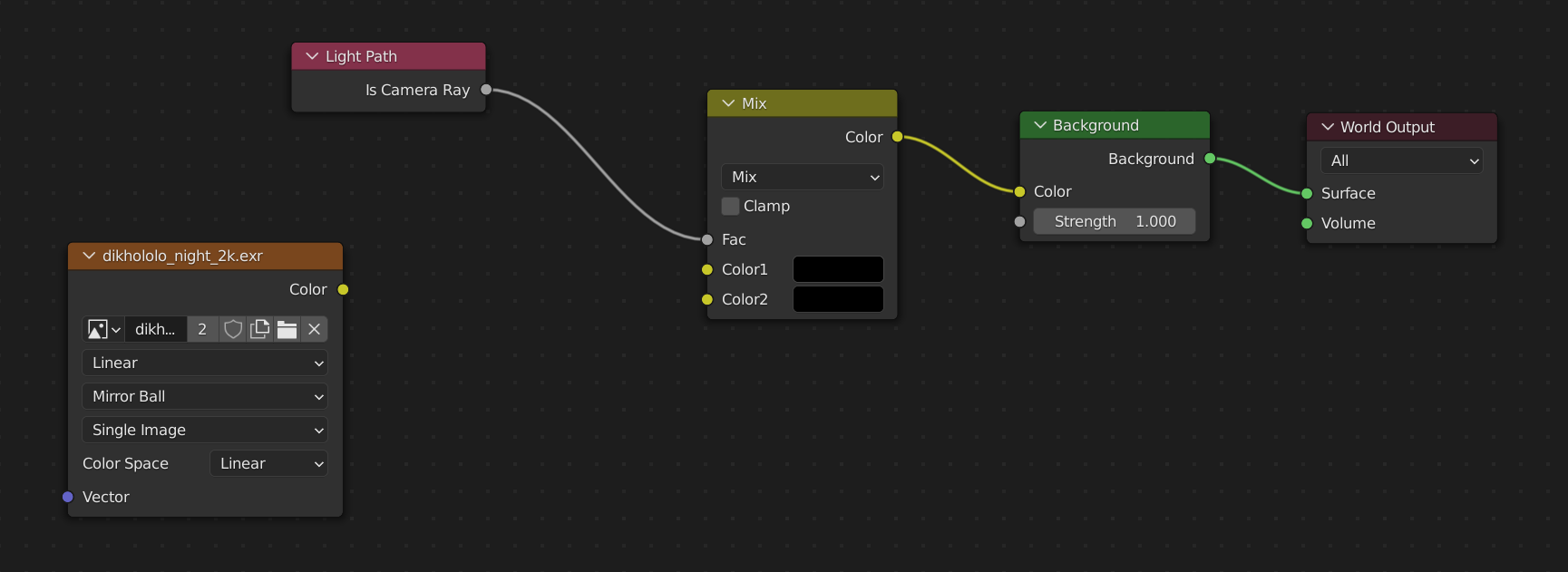

    “Mix RGB Node is applying a white light. You can control its output by adjusting the white color in the mix node.”
    I found it! It was the “color 1” of the “Mix” node but I had to dispatch HDR image node from it to be able to change it to black.
    Wow!
    #50129
    You even can disconnect it from Background node and change color of the node directly.
