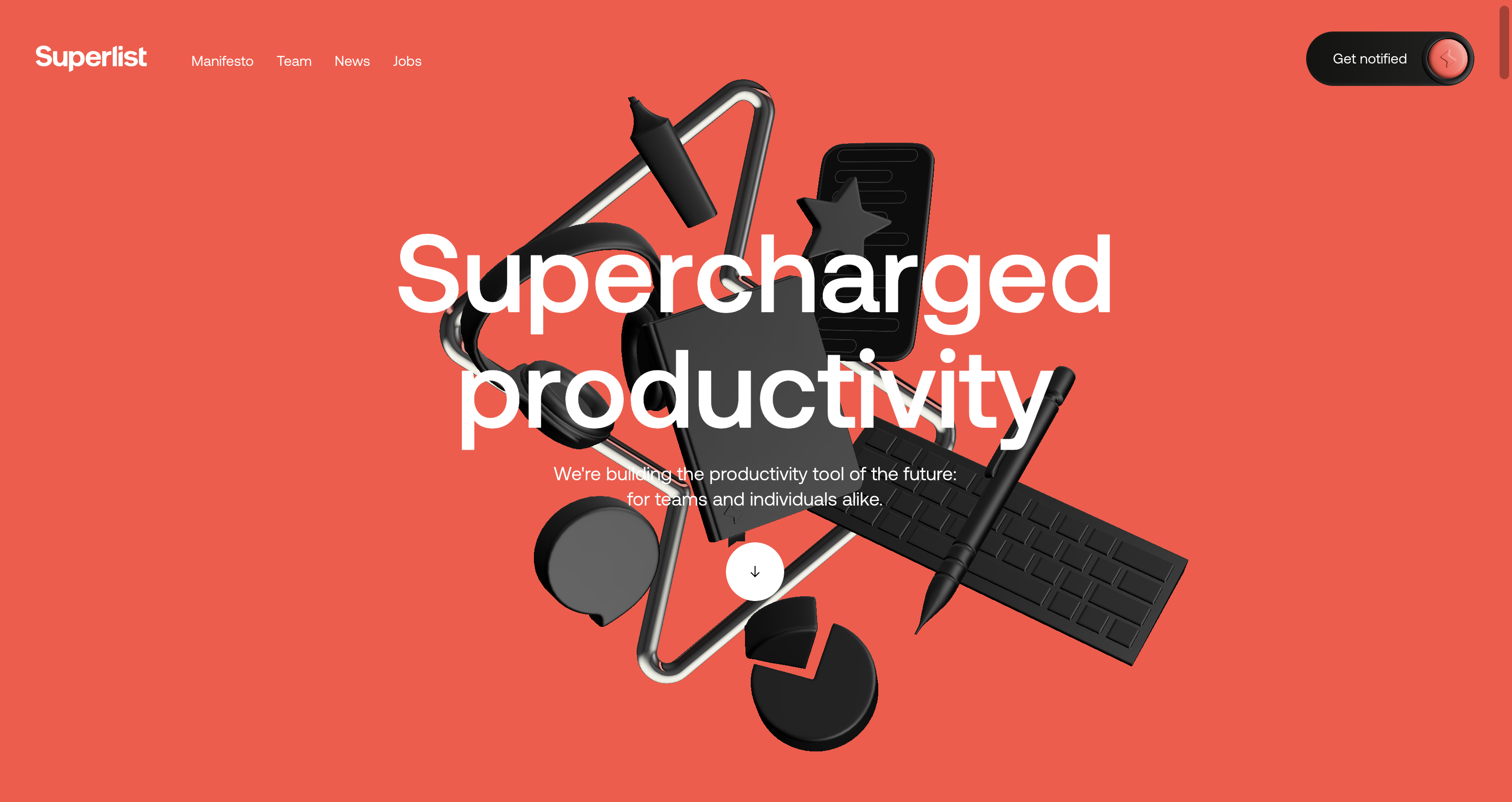

    Hi, quite new to Verge3D so apologies if this has already been answered. I’m looking for the best solution for getting my objects to look at where my cursor is, so when i move my mouse to the left the objects rotate to the left, etc. Essentially something like the example below. What’s the best method of achieving this?

    Not quite, it was moreso the first animation that gets loaded as screenshotted. The items in the scene point slightly towards the mouse when ever it is moved in any direction?

    Lots of options to achieve that subtle movement.
    You can add a track to or look at constraint. You could use orbit constrained to amount of rotation and eliminate it at a scroll distance. You can specify object rotation based on mouse mouse or touch location. Sure the are other options too.
