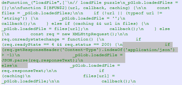

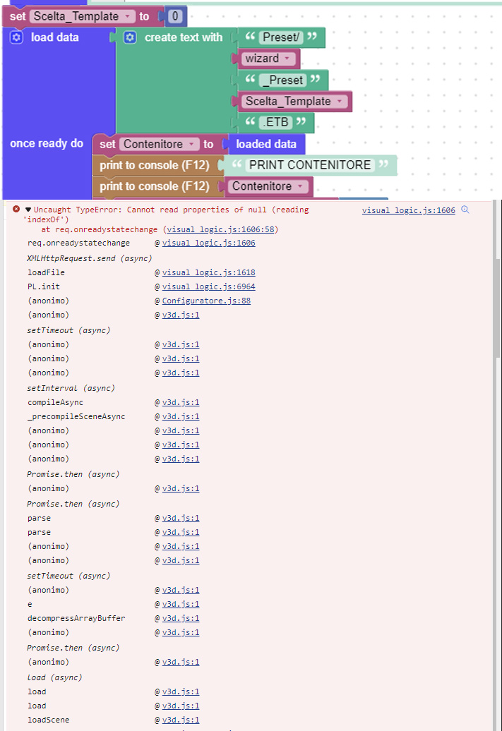

    I’ve tested this https://github.com/json-iterator/test-data/blob/master/large-file.json big json file. No problem with any extention.
    Change a little the function loadFile in visual_logic.js. Remove these three lines
    if (req.getResponseHeader('Content-Type').indexOf('application/json') > -1)
        _pGlob.loadedFile = JSON.parse(req.responseText);
    else
    and try again.
    Can you share one of your .ETB files?
    #55521
    fsguegl
    Thanks a lot KDV!!! :heart: :good: :good:
    Deleting this 3 rows from “loaddata” function, all work as before,
    using ETB extension and with “readJSON from” loaded data.
    ia also have attached an ETB sample file
    thanks again and
    have great days!
    Franco
    #55525
    Now you can get rid of this problem removing the unnesessary lines from puzzles.min.js in order not to correct visual_logic.js every time
    You’ll find them twice, remove the first ones. But first make a backup )))
