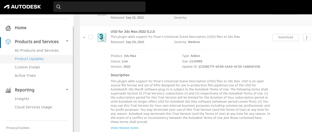

    I’m using 3DS Max 2022 but the USD Preview Material node isn’t there still.
    All the other new features in Verge3D 3.8 that I checked seem to be present, just missing the new USD material.
    Is there something else I need to do?
    #45245
    Hi!
    You need to install the USD plugin for 3d Max that you can download from the products and updates page of your Autodesk account:
    Verge3D Developer
    #45419
    vern
    Ok, Thank you Nurgeldi!
