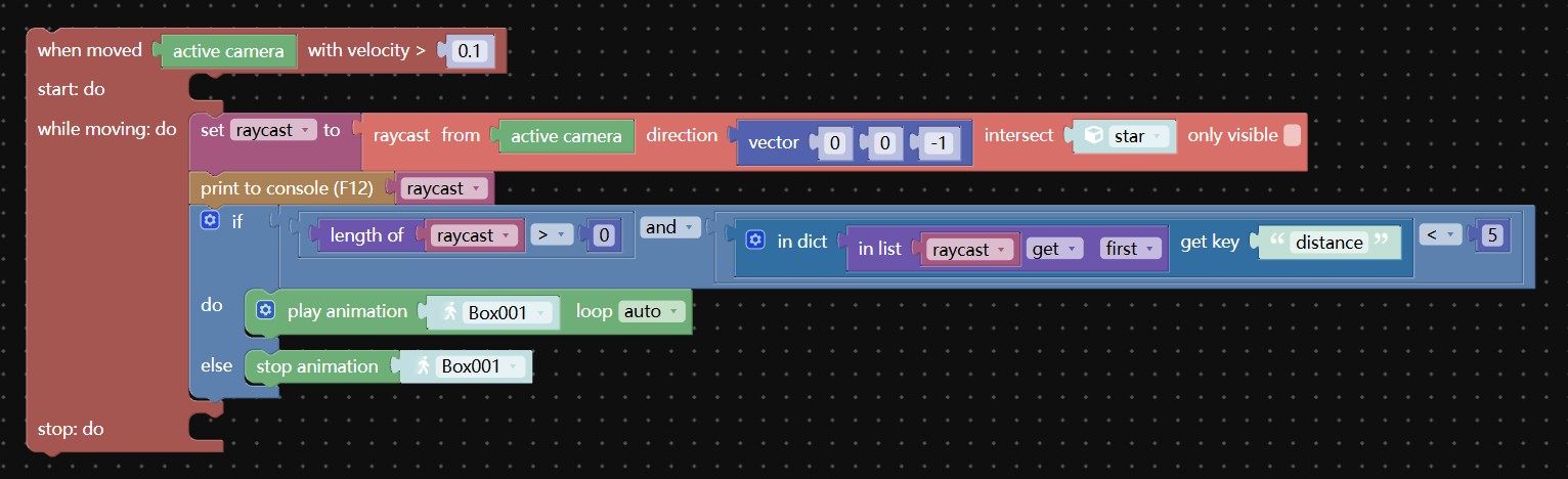

    -Cast a short ray from the camera forward. -Check if it hits your trigger mesh.
    -If yes, start the animation.
    Hi,try this demo
    #84148
    boing
    Oh wow, thank you.
    I just about managed to recreate it! :yahoo: Way above my “puzzle skills”!
    Thank you again!
    #84150
    Indeed, for the small scenes raycasting to the ground would be the best option. However, for large environments I’d suggest using the physics engine to implement proximity sensors (with the ghost objects)
