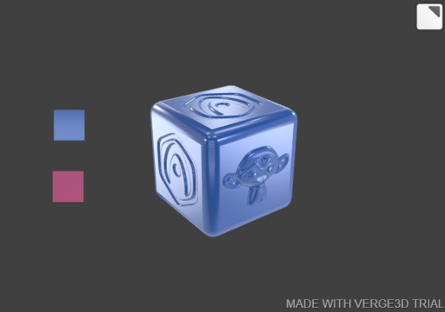

    I would like to make a transition between colors / textures as in the scooter example.

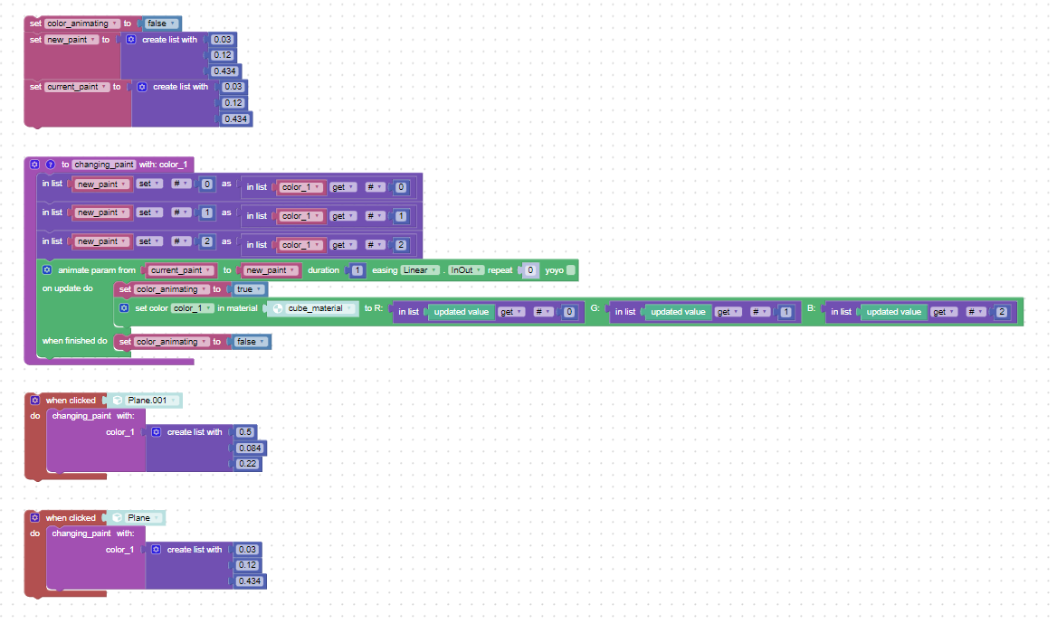

    i solved, i made the transition between two RGB colors, copying the scooter demo.
    the variable “color_1” is the name of the RGB channel in blender.
    the numbers in the “create list with” are the “R-G-B” values
    I am attaching my simplified script. B-)
