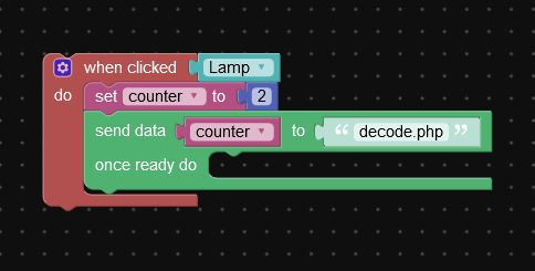

ParticipantI have a question..
i want send data with “Send Data” Puzzle to PHP File. But they dont have any request.. no Data sent? The $_POST array was empty..
Where is the mistake.. i don’t know
But here my simple Test (Result -> int(0)):
2019-11-29 at 6:28 am #21495

In the same html run a $.ajax POST (2 Objects to test.php).. it work’s perfectly. Only the “send data” Puzzle .. send NO data.. no String, no Number, no Object .. nothing.2019-12-02 at 11:50 pm #21605chaac
Participantok, i have the solution!!
The function sendData() send the request Header as Content-type ‘application/json’, and strings as ‘text/plain’. Anyway.. the $_POST Array ist always empty!
On PHP we must decode the file content as json.. that’s all
if (empty($_POST)) { $_POST = json_decode(file_get_contents("php://input"), true) ? : []; } print_r($_POST);Result are an full Array!
