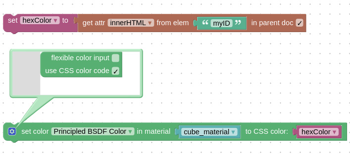

    I’ve never worked with code before but I got this color picker into my Webflow project along with my Verge app. I’m trying to take the hex output from the picker and use it for a color value in my material however, I’m not sure how to go about setting up the puzzles.
    #29976
    The picker color value can be obtained by get attr puzzle.
    Then you can check ‘CSS color’ in the set color puzzle and use the obtained color value with it.

    I tried “myID” in the element slot and had no luck. I tried “Picker” because that’s what I believe it’s named in webflow but no luck either.
    #30090
    from your screenshot I can see that the id is “hex”
