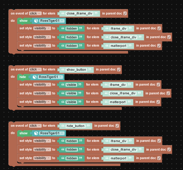

Mikhail LuzyaninStaffYou just need to create a a HTML element using Webflow or any other HTML editor or make it by hands in text editor then just use Set Style puzzle to change it’s display prop.

jdhutchinsonCustomerThank you Mikhail! How can I add the functionality for a single button to toggle that display property?
I also used visibility property with hidden/visible, I’m wondering which is best for the optimised result?
Eventually, these pop up models will be associated to annotations and point to unique urls. I need also some way that when the display goes back to none, that the iframe will be refreshed next time it is opened. So, in the example of the video, each time the iframe window is opened it would need to start the video from the beginning. Maybe there is some sort of reset property?
I’m currently using Webflow, and it is working really well for me already.
2021-05-19 at 6:56 am #41088
Mikhail LuzyaninStaffHow can I add the functionality for a single button to toggle that display property?
You need to use HTML Event On Click puzzle for that.
They do the same with little difference. Some explanation can be found in the internet.
If you need to return your html element to default state but you made changes of it’s text, color or something else you will need manually change the text, color or anything else again with proper puzzles. Do not know about a video, leave this question here may be somebody else can help you.

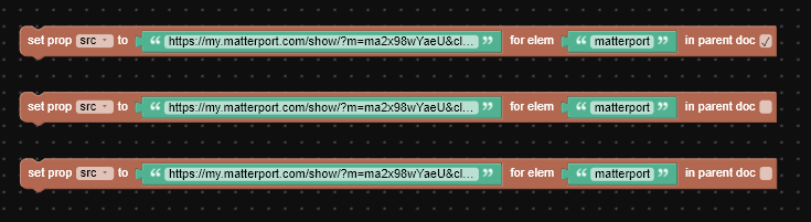

jdhutchinsonCustomerHi Mikhail,
Also, in basic cases as the attached, is it necessary for me to disable these puzzles before I fully implement them? For the purposes of proper debugging.
See in the image I have made the three different ‘src’ properties I will set to at different moments. Do these ‘run’ without a ‘Do’ action beside them? I am assuming not.
2021-05-19 at 8:28 pm #41153
jdhutchinsonCustomerWow! That’s really nice. Did they use V3D?
I see they useda display: none property. But, they were able to show it again. So I think my mistake must be not putting the right display value back (i.e. not just Block, but whatever the correct display state is.)
2021-05-20 at 6:37 am #41161
Mikhail LuzyaninStaffSee in the image I have made the three different ‘src’ properties I will set to at different moments. Do these ‘run’ without a ‘Do’ action beside them? I am assuming not.
You need to put them in any Event otherwise they will run on app start.

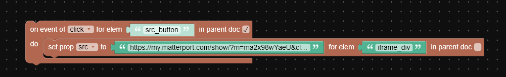

2021-05-23 at 4:27 pm #41269
jdhutchinsonCustomerThanks Mikhail. That makes sense to me.
The next issue I’m coming up against is amending the iframe src attribute depending on which iframe is clicked. Alterntaively, I make iframes for each internal tour, however this means I have to have a div in my webflow for every single tour.
I tried the set src puzzle, but I must not be referencing the src attribute correctly via element id.
