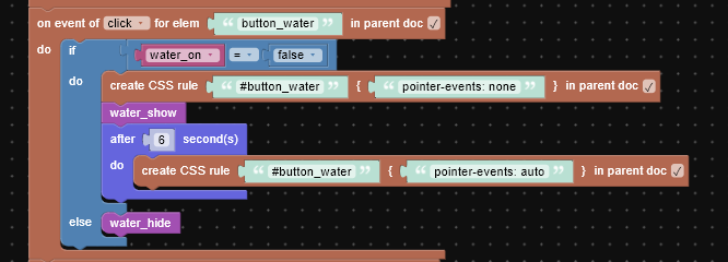

    #44528
    jdhutchinson
    Here’s an example of what I want to achieve. On click, set a css rule, run a procedure, once procedure is done, set a css rule which undoes the one I made before.
    PS not sure setting the css rule and then setting it to something different overwrites the previous value or not? Is that how it works? How can we ‘edit’ or ‘set’ a new CSS rule we have created with a puzzle?

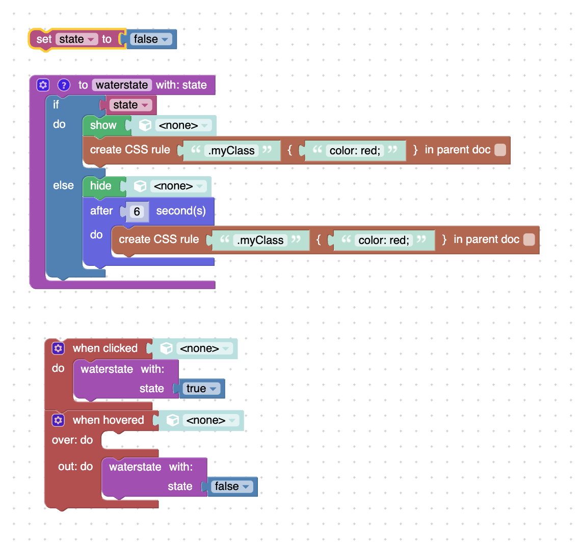

    #44565
    puzzles are executed line by line but are more
    more object-oriented than straight linear execution
    As an example you might have three puzzles
    1. global variable x=0
    2. myprocedure (contains a change to variable X so that X will equal 1 and it will take a 1 min to process)
    3. if x=1 text = blue
    The execution of these is linear. Keep in mind line 3 is not waiting for the line 2 procedure to complete during its execution and thus will probably never see a state where x=1.
    To solve this use a procedure with a return and then run the condition based on the return. The code might look like:
    2. if (my procedure (with return)=1 then text = blue
    this will cause it to wait.
    Procedures with inputs and returns are great but can seem complicated at times.
    Anyway…you might want to try something like the attached. Might be simpler ways
    #44567
    here ya go

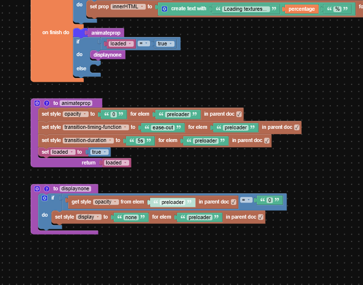

    #44657
    jdhutchinson
    See, I thought the attached might have worked, for me to display:none ONLY once the procedure before had finished. But no dice. I seem to be going backwards with it, don’t see why it should be so hard to fade something out just because it’s in the init tab!
