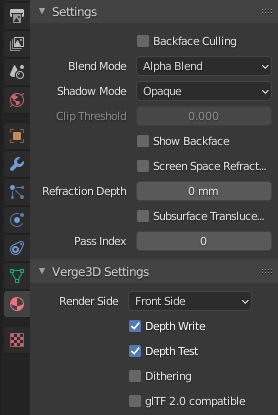

    v3dbeginner
    Is there any way to make glass transparent in browser?
    #56516
    Change the material blend mode from Opaque to Alpha Blend and adjust Alpha value in the Principle BSDF node.
    #56755
    v3dbeginner
    Thanks! That worked well. My last concern is that there is still difference for the hands and back cover. I am using EdgeSplit, but the problem remains reradless of the angle value.
    #56757
    Try to clear Custom split normal data and set Auto smooth to 30. And, maybe, you should remove several sharp edges.
    #56758
    v3dbeginner
    thank you! everything looks good now
