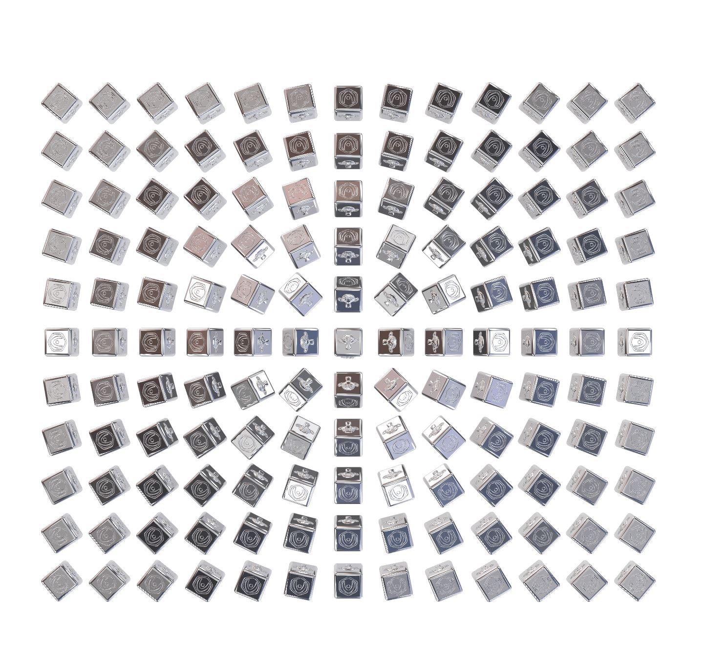

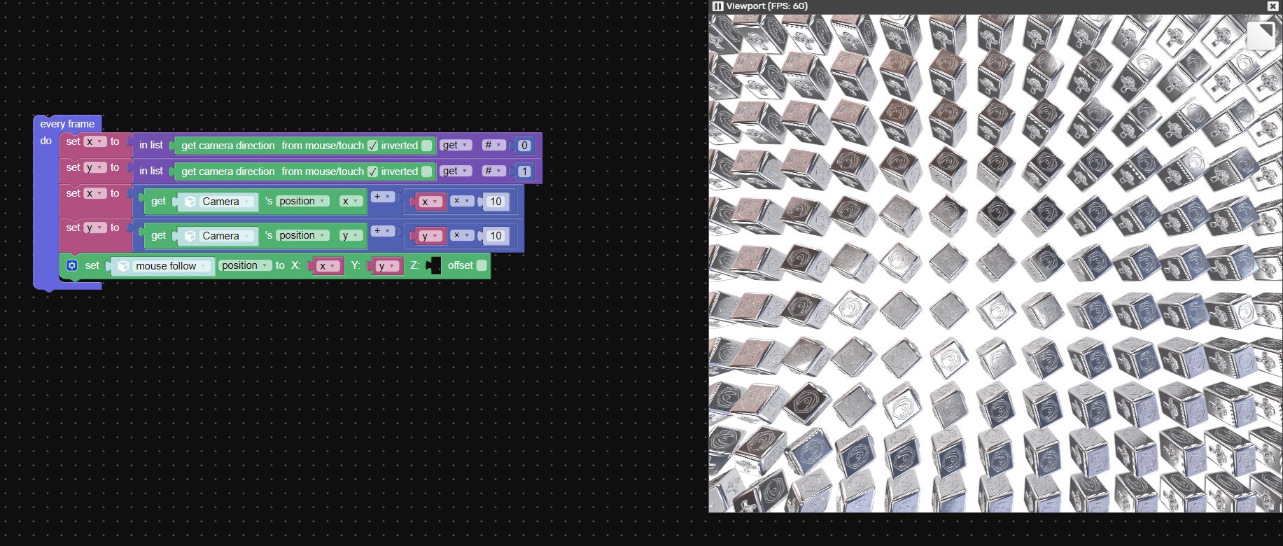

    Today I realized that the “track to” modifier will not work with a puzzle that is driven from an orthographic camera.
    Example: no problem having all objects to point at the mouse cursor, works well.
    But won’t work with an orthographic camera. Attached screenshot with simple visual explanation of what’s going on.
    The moment the Perspective Camera is turned to Ortho, it will freeze.
    Since in the last release the S8S team seemed to be working on Ortho camera issues, maybe this one could be reviewed? Seems not to be reading or returning valid position values.

    Thank you for the proper explanation of this issue. We’ll take a look!

    Hi!
    The problem was solved, the fix will be added in next release.
