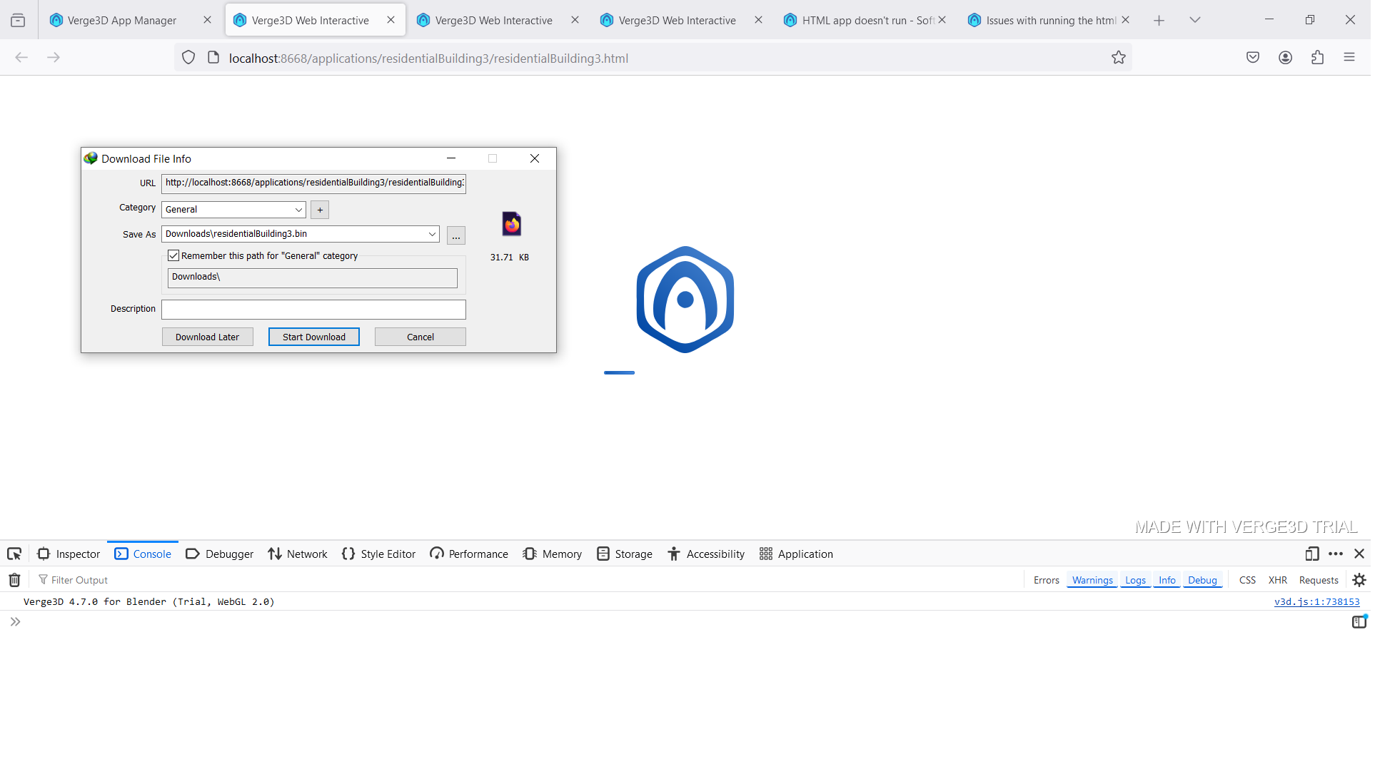

    I have installed Verge3D for Blender 4.7. My Blender version is 4.2.1. When I create a new project in the Verge3D app manager, I can run the HTML file with no problem. However, if I modify the Blender file (e.g., by removing the default mesh and adding a simple Blender cube mesh) and export it to glTF, the HTML file won’t run anymore. A new download popup appears, and it gets stuck in the loading phase.
    I’ve also exported the GLB file. Unlike the gltf file, It can be opened as scene viewer. Still, I can’t run the app. I don’t know what is wrong!
    The funny thing is that If I don’t remove the default cube everything is alright. I mean I can add other meshes and the program still runs. How ever If I remove the default cube, the issues appear. I don’t know if its only me facing this issue or this is how the verge3d works (only if the default cube is in the scene)

    The strangest part is that everything works as long as the default Verge3D cube remains in the scene. The moment I remove it, the app breaks.
    When I open the HTML file from the app manager, a download window appears for the new .bin file, and then it gets stuck in the loading phase indefinitely.
    As a programmer myself, I’m confident there’s nothing wrong on my end. I really need some technical support here.

    The browser console doesn’t show any error. The only console message is: Verge3D 4.7.0 for Blender (Trial, WebGL 2.0).
    #77445
    Really? You don’t see the reason? Disable your download manager :wacko: Or add .bin to exclusions…
