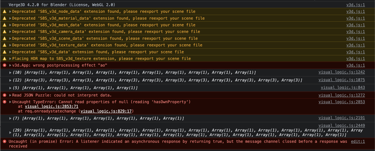

    Hello, I am getting an error once inspecting my project using the developer console (Chrome) after upgrading to the latest Verge3D version: 4.2.0 and latest Blender version: 3.2.2
    I have attached the screenshot of the error message I got in the console.
    Any help is highly appreciated.

    re-export
    about JSON read here https://www.soft8soft.com/topic/verge3d-4-1-1-maintenance-update/#post-55477
