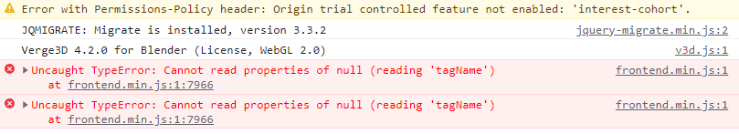

    #60701
    sfwq
    I exported the verge3d project and attached the embedding to the page.
    #60702
    link deleted
    Your app is working. No errors concerning IP adress.
    You’d better add a couple of attributes in the <iframe> tag to remove the vertical scroll bar. frameborder="0" and style="position: fixed;"
    There is a problem when entering the full-screen mode
    And you will have more problems if you plan to use puzzles’ logic and continue to use the cross-origin iframe

    #60718
    Yeap, the page is accessable, the app is working. The same issues as with the previous page.
    Ask your client to ping v3d.net and cdn.soft8soft.com
