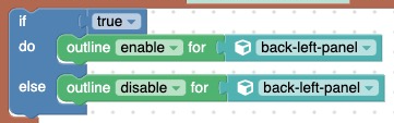

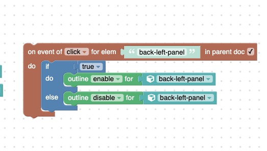

    I want to use the HTML element click event to make the outline enable of the cap panel,else it will disable.
    Now,the outline can be enable,but can’t be disable.
    Please check my puzzle, where is the mistake, thank you!
    #61448
    Your logic ALWAYS enables outlines.
    Use variables.

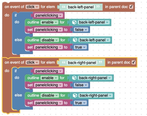

    I modified the puzzle according to your tips:

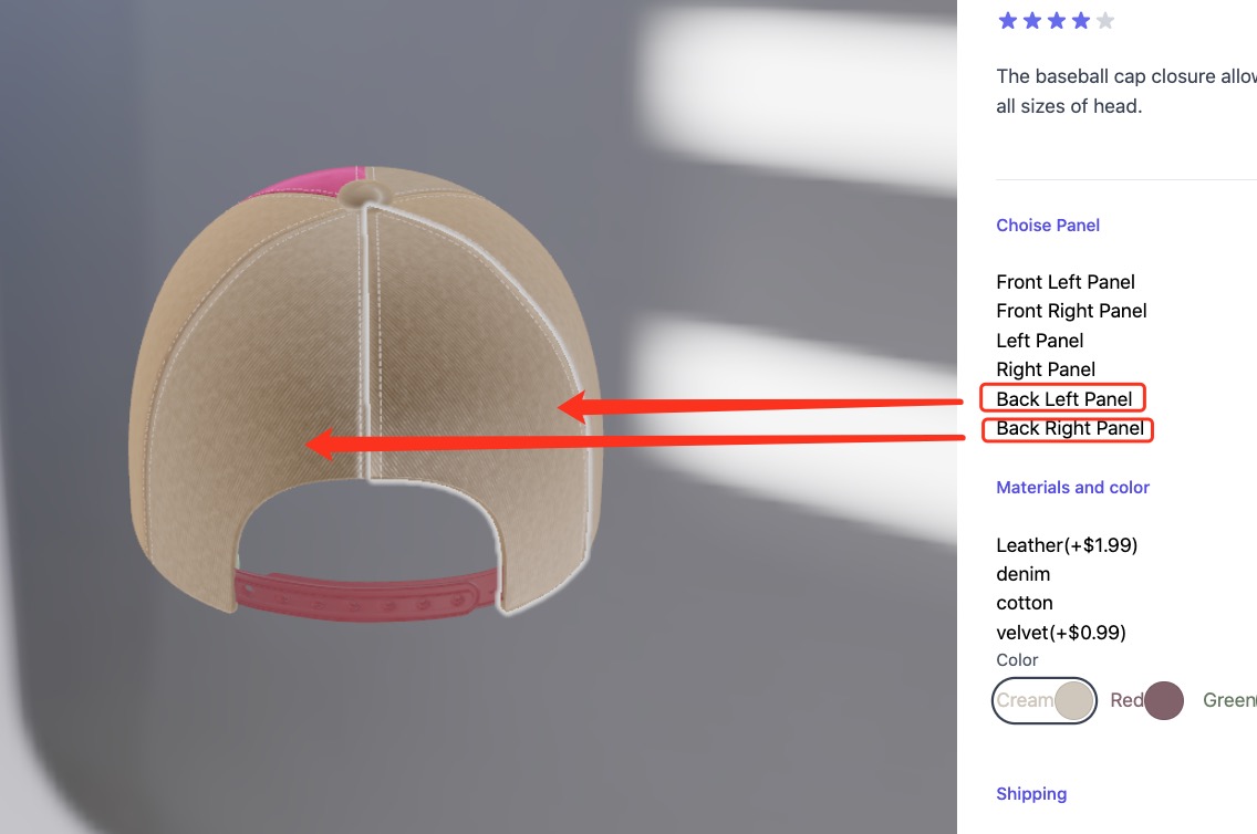

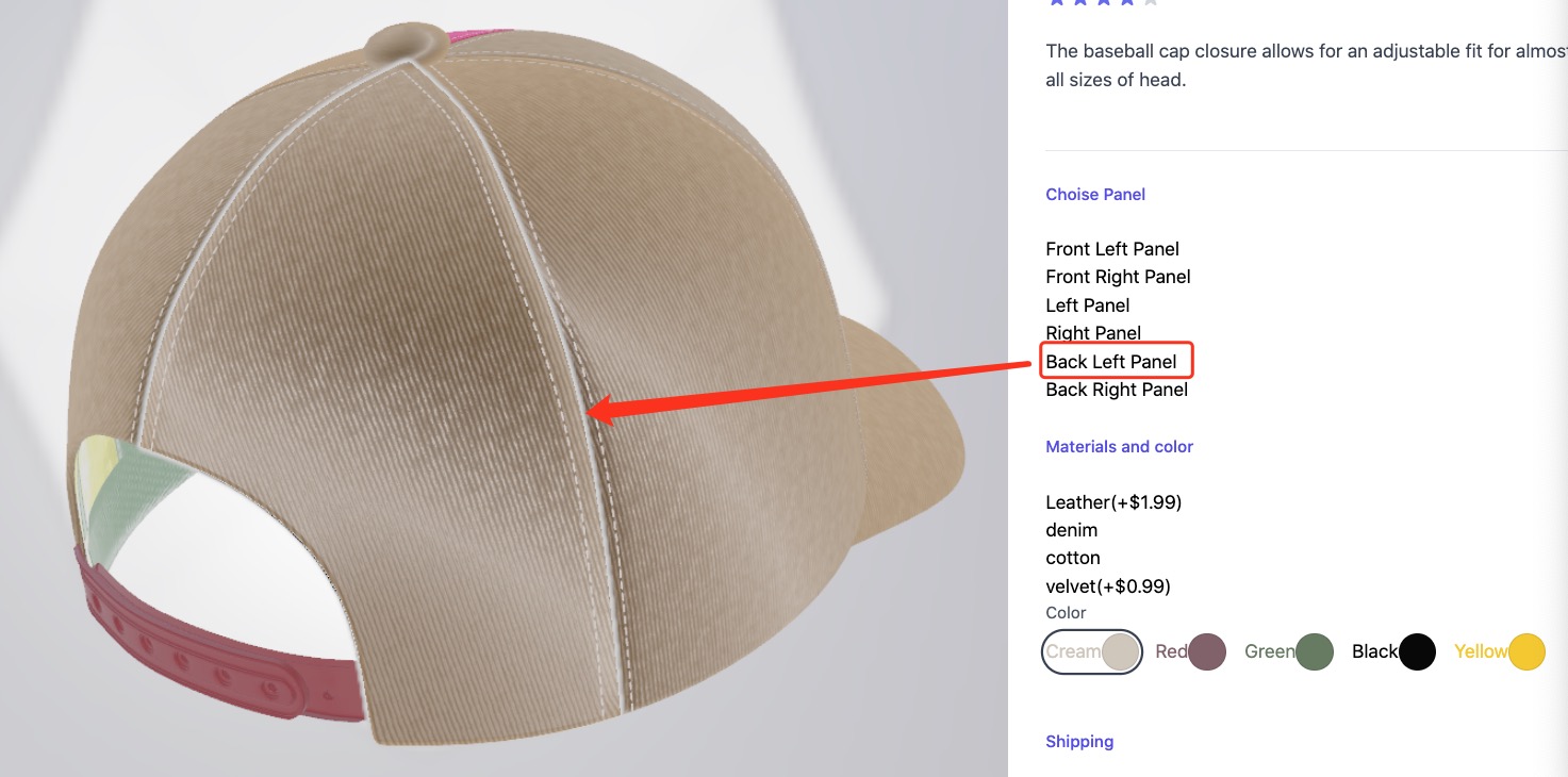

    When I click “Back Left Panel” on the webpage, Outline is enbale, when I click it again, Outline is disable.
    I need: when I click the “Back Left Panel” on the webpage, the back left panel of cap’s outline is enable, when I click the “Back Right Panel” on the webpage, the back right panel of cap’s outline is enbale, at same time another panels of cap’s outline is disbale.
    Please tell me how do i do? thanks.
    #61463
    Continue using variables and logic. Save the outlined object’s name to a variable. Compare names of objects with this variable before making them outlined.
    #61464

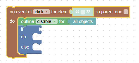

    Pandern
    What I usually do is insert a ‘outline disable for’ ‘all objects’ before the logic puzzle enables it again for the correct object.
    Kdv’s suggestion might be a better solution for your situation though
    #61467
    yijin
    Thanks Pandern, your suggestion is good, very close to my idea,thank you very much. :good:
    Thanks Kdv, i think your suggestion might be better, could you give me a sample? :yes:

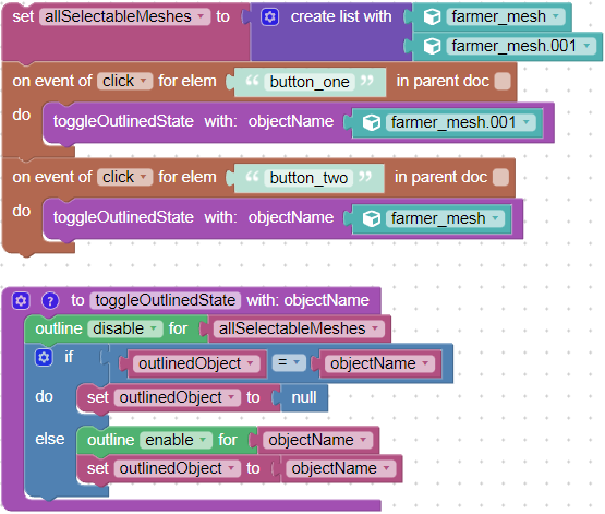

    #61504
    The logic is simplest
    https://v3d.net/gsq
