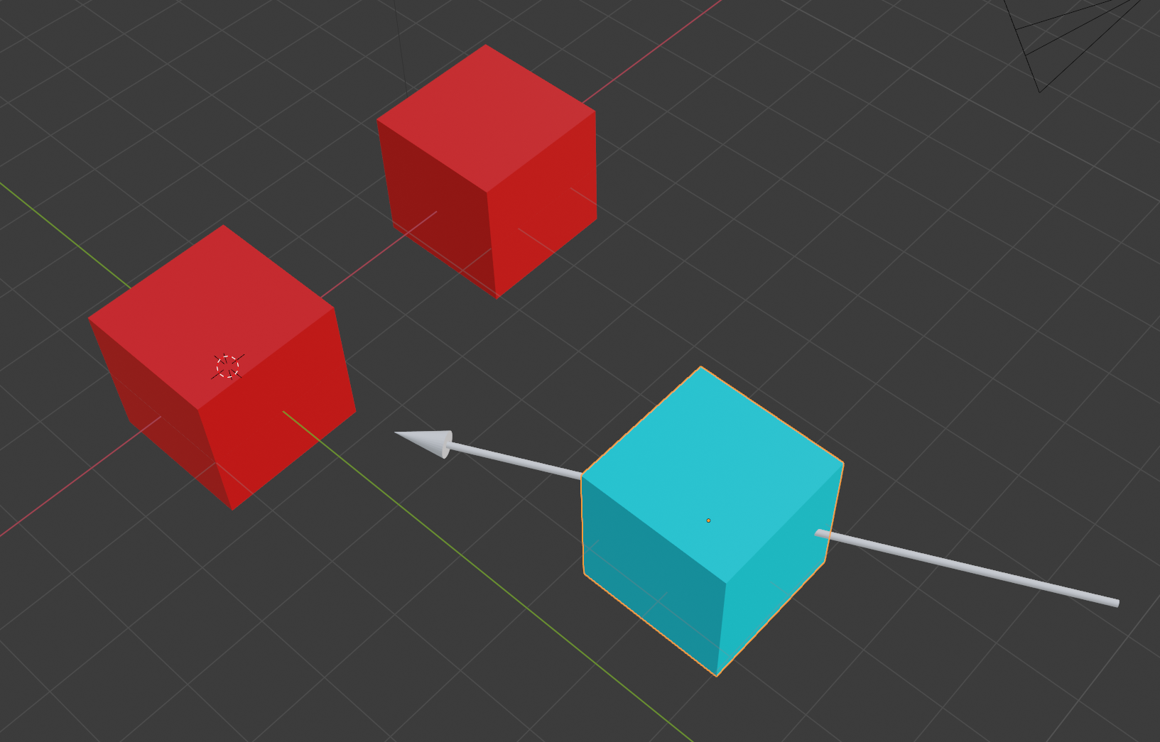

    Hello,
    I have the following problem:
    1) I have a 3D scene with e.g. 3 cubes.
    2) I want two of the cubes to perform actions when hoovering (raycast).
    3) The third cube should be ignored by the raycast, especially if it is in the way and prevents me from hovering cube 1 or 2.
    Question:
    How can I remove the third cube from the raycast list? Is it possible with the puzzles or do I need the “exec script” puzzle?
    If I need the “exec script” puzzle, can someone kindly give me the code?
    Thanks in advance
    Anil

    The third cube is not included in the list for hovering objects, it is simply a part of the scene that is in the way of the raycast, which is why the back cube cannot be selected directly. The blue cube should not be visible to the raycast, so to speak.

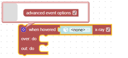

    #59493
    #59495
    Anil Kohli
    Thank you so much, it works!!! :yahoo:
