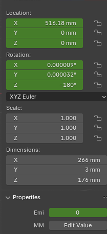

    Good day,
    I am using Verge3D for Blender (4.2, 4.4).
    In my scene I use attribute “emi” to create a highlight effect for objects (an animated scene where the object gets highlighted at certain frames only – e.g. blinks).
    In a blender scene everything works fine, however, when I export it to Verge3D or use Sneak Peek, this effect is not working.
    Could you please recommend on how to implement this properly to Verge3D?
    Note that I am not using Puzzles logic and will be implementing the switch in a custom script.
    Best,
    Jan
