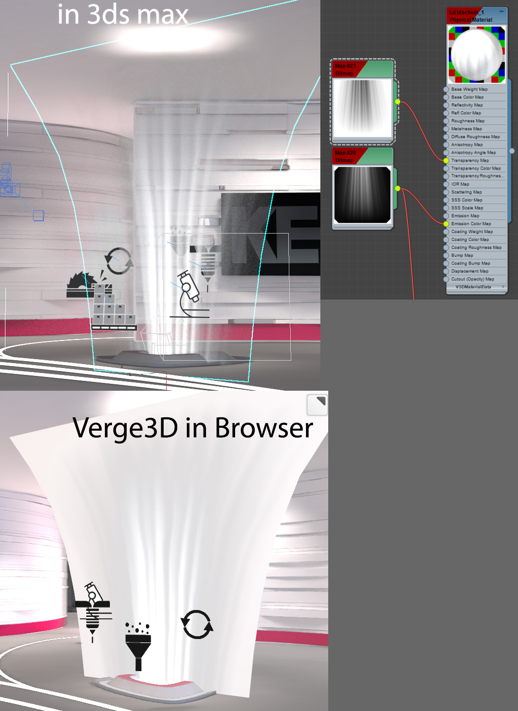

    I didn’t get physical material working with emissive and opacity texture at all so I’m forced to use Standard Material which can only be emissive max 100% and shades flat. I need more than that. What would be a physical material setup for godrays? Tried and failed, see attachment.
    #49321
    Need to set-up a blend type for the material for example Hashed.
