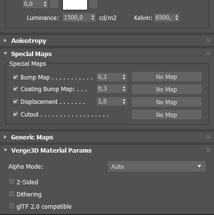

    Hi all. I have a problem…
    I created a new 3dsmax material. I have 3 maps: albedo, AO and Normal.
    AO+Normal have the same “tile” so u=1, v=1.
    Albedo instead, a value of U10 and V10.
    When I export my scene to verge, my AO and normal are all x10. Does Verge not support different UV multipliers?

    Do you use compat gltf 2 material or not? If yes then you can’t use different tiling for the different images of the same material and masimum two uv-map.
    #15684
    karonte
    yes! it works!. thanks
