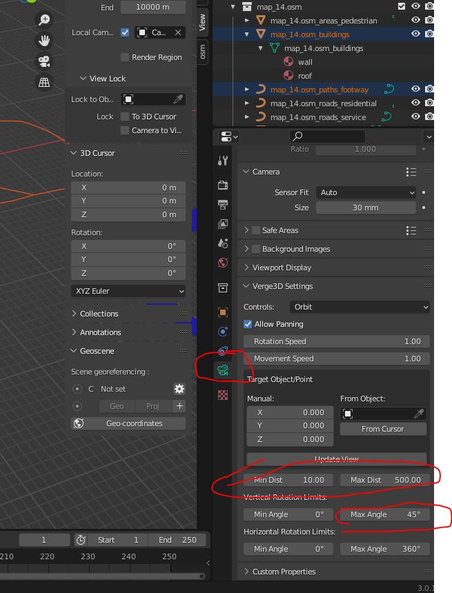

    Hello, I mainly work with OSM maps, so my scenes are large. When I try to look at the scene in the web view, I can’t zoom out far enough to see the entire map. Am I missing a setting? I attached a video as an example.
    Thanks
    #49961
    eltel2910

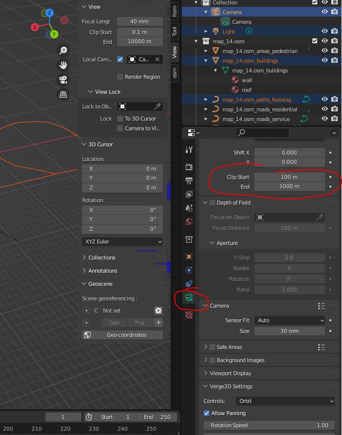

    I think I pretty much answered my own question by playing with the Camera settings. I attached some screen shots of what I changed, incase it may help someone else
