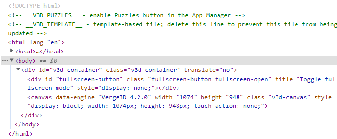

2023-01-10 at 9:20 pm #59484vision
Customer2023-01-10 at 9:24 pm #59485kdv
Participantyou don’t see the AR button because your html file does’t contain this button. nothing’s to be seen.
replace your
augmented_reality.htmlwith the attached file.Attachments:

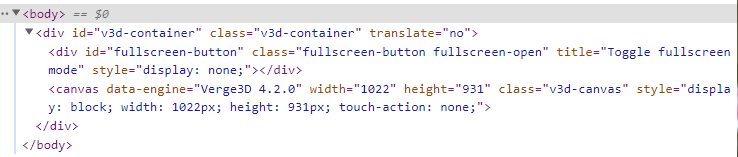

g.grangerCustomerHi kdv77kdv and vision,
I think i have the same problem now, see link: https://cdn.soft8soft.com/AROAJSY2GOEHMOFUVPIOE:22487a8500/Multiwalker-AR2/augmented_reality.html
It has always worked in the past, but I don’t see an ”enter” button anymore :(
How do I get to doctype script and replace the html file?Thanks in advance,
Kind regards,
Giselle
2023-01-24 at 10:25 am #59800kdv
ParticipantYou don’t have this button in the html file => you dont’ see this button. Nothing is to bee seen.

ParticipantJust open your app folder in some file manager and replace
augmented_reality.htmlby the file attached above.I don’t know how and from where, but both of you have the corrupded file
augmented_reality.htmlwithout buttons and warnings…or is there an improved example available (adjusted farmer example).
