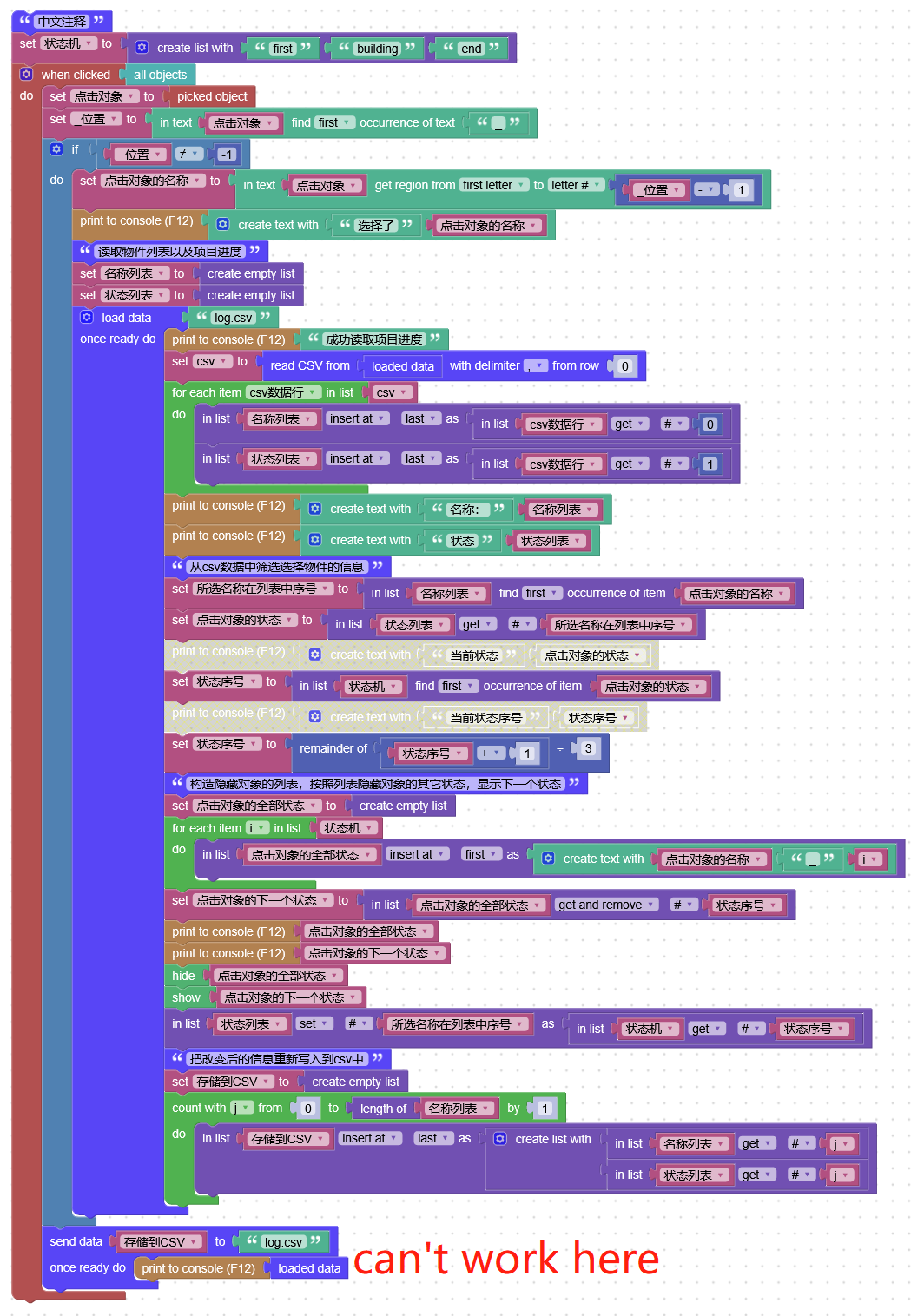

    I tried using “load data” and “send data” to save changes to the scene so that the next time I reopen the project I can revert to the previous information,but “send data” doesn’t work properly for some reason.
    What is wrong?
    How can i fix it?

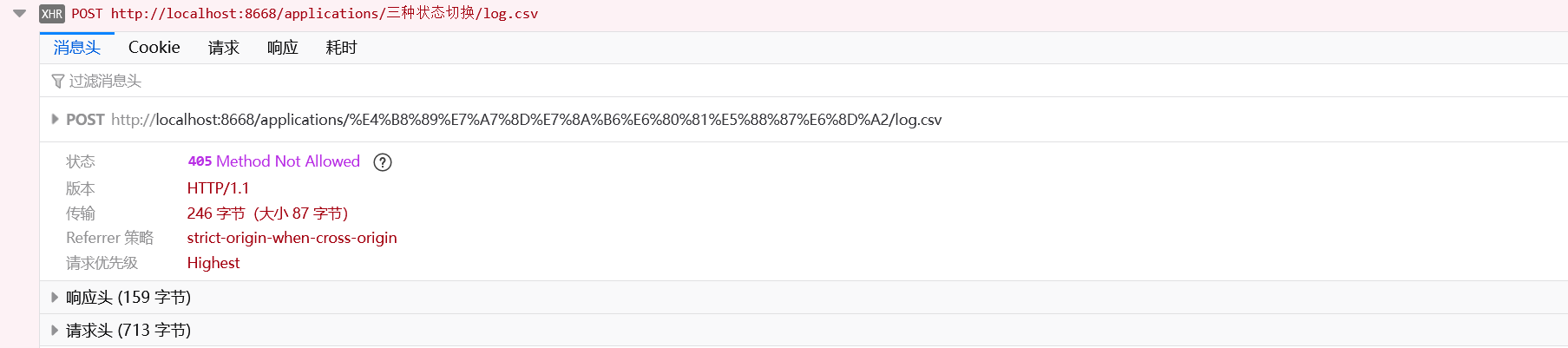

    You’re just not allowed to write data into the app’s directory. And won’t be. Check out the Custom image demo puzzles…

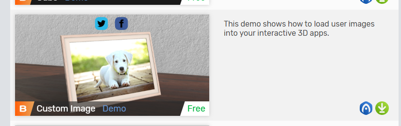

    Could you please tell me which demo it is?
    #61645
    This one
    If your log.csv is small then you’d better save it into localStorage like here https://v3d.net/a4k
