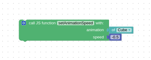

And then call it in puzzles whenever you want to change the speed:
– on the screenshot above -0.5 means that the animation will play backwards with the half of the original speed.
