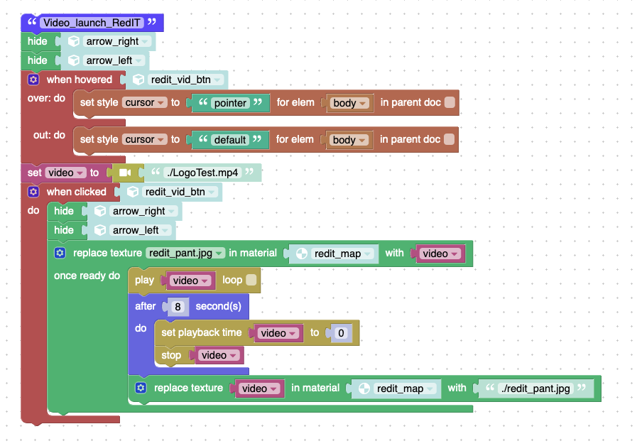

    Hi all… i’m getting problems with a video texture
    I have a button that launches a video on a 3d screen with an applied texture.
    I can launch the video with no problem, but when the video is finished i cannot return to the original texture so the screen can interact with other buttons that launches other info on that screen..
    I attach the puzzle of the video launch, to see if someone can help me to get this work
    Thanks!!!
    Troskhy

    do you have redit_pant.jpg (with this exact spelling) file placed in your application directory? You might also need to check the browser console for possible errors, such as 404 (not found).

    Hi Alex.. yep, it’s place inside the application directory, even a create another file whith another name to see if that was the problem, pointing them to “./redit_pant.jpg” or only “redit_pant.jpg”.. but none of them works…
    I’ve checked the error console both in firefox and chrome, and get none errors..
    It’s my puzzle right build?
    I think this action should be easy to implement, but don’t know why i’m unable to make it work… any help to make this work would be amazing, as i need it to work this way
    Thanks in advance!
    Troskhy

    Please use print to console puzzle to debug your code. Just print something near the blocks in the video snippet to see how you code is being executed.
