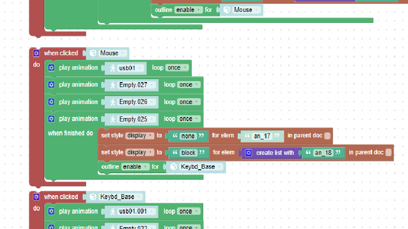

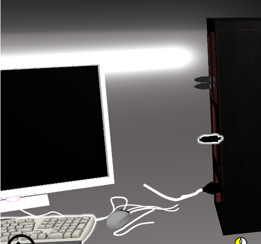

    I have a blend file with wired animations that uses catenary curves.
    For animate the curves, I make Hooks to control my curves and create keyframes from those hooks. I have set in Verge3D puzzles to play hooks animation, but but the animation doesn’t work. Is something wrong or is something missing? is it possible to run animation from empty plain axes in Verge3D?
    #57251
    You need to add shape keys to animate these cables.
