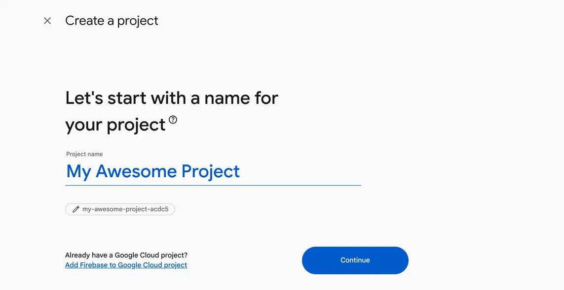

Creating a Firebase project
To create a new project use the Firebase console (you need a Google account for that):
Create a new Firebase project
and add/register a new web app as part of it:
Create a new Firebase app
Read more on creating web-based projects in the Firebase docs.
On this stage you obtain a pair of Firebase identifiers for your project and app. The actual production will happen in the Verge3D App Manager.

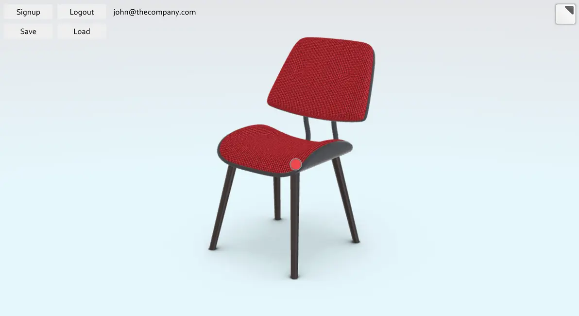

Firebase-based 3D interactive chair configurator
... all you have to create a configurable chair model which can be rotated/scaled and a bunch of UI buttons in the top-left corner of the app.

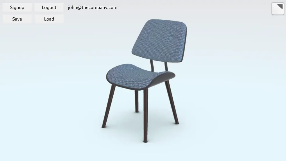

Creating HTML for the app
The configurator app is operated using color picker attached to the model as well as 5 (4 visible + 1 hidden) buttons, located in the top-left corner of the app:
Buttons for Firebase-based chair configurator
  • Signup button — used to create a new account
  • Login/Logout buttons — used to login/logout. These are 2 distinct buttons, but only one is visible.
  • Save button — displays dialog to save chair configuration
  • Load button — displays dialog to load named configuration from the list
Also there is an email text field. It displays "Please signup / login" text if user is not yet logged in, or user email otherwise.
Let's discuss everything in detail.

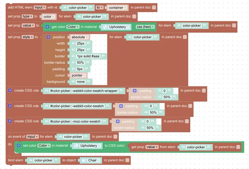

Color picker
Here we use the <input> element of type color attached to the model with the bind elem puzzle. When the user chooses some color the input event is generated. To catch it we use the on event of puzzle. The color itself is applied to the model thanks to set color.
Puzzles to create HTML-based color picker
Starting with Verge3D 4.13, you can use the Color Picker from the puzzles library to create such feature in a drag and drop fashion.

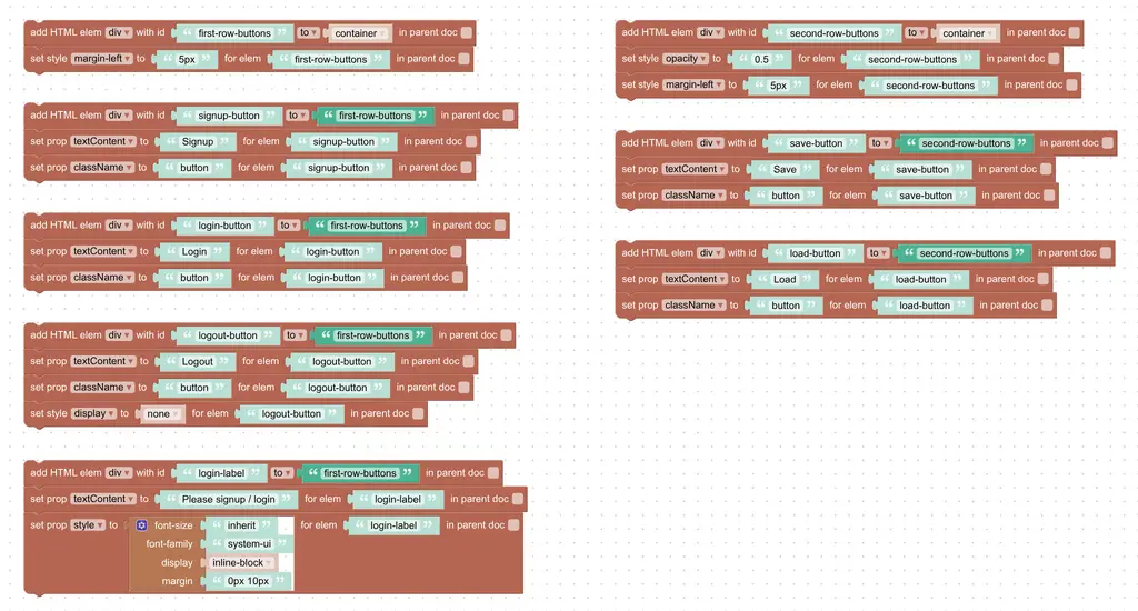

Buttons and text field
We use add HTML element, set prop, and set style Puzzles to create all 5 buttons and a text field:
Buttons Puzzles logic
These controls are built from the <div> HTML elements arranged into two rows (first-row-buttons and second-row-buttons).
The buttons have the following IDs:
  • signup-button
  • login-button
  • logout-button
  • save-button
  • load-button
To make the logic more compact, we create a new CSS class .button which will be used to assign styles for all buttons at once:
Buttons CSS logic
The text field login-label is used only once, so we assign its style right after creating the corresponding <div> element.

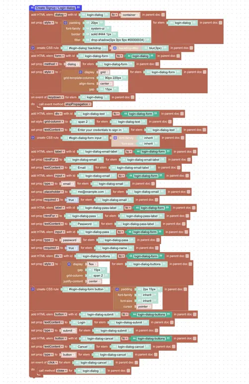

Signup and login forms
The login-dialog contains two <input> elements and two <button> elements. It is used for both signup:
Signup dialog look
and login:
Login dialog look
The Puzzles that create it:
HTML Puzzles for creating login dialog

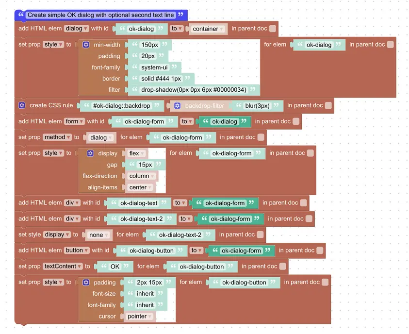

OK and error messages
The ok-dialog contains 1-2 text lines (rendered as <div> elements) and the "OK" <button> element. It is used to display information and errors to the user:
Ok dialog look
HTML Puzzles for creating OK dialog

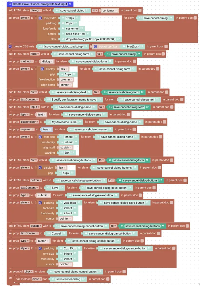

Saving configurations
The save-cancel-dialog contains an <input> element and two <button> elements. It is used to display the dialog for saving chair configurations to the remote database:
Save dialog look
HTML Puzzles for creating save dialog

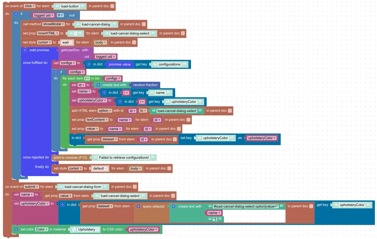

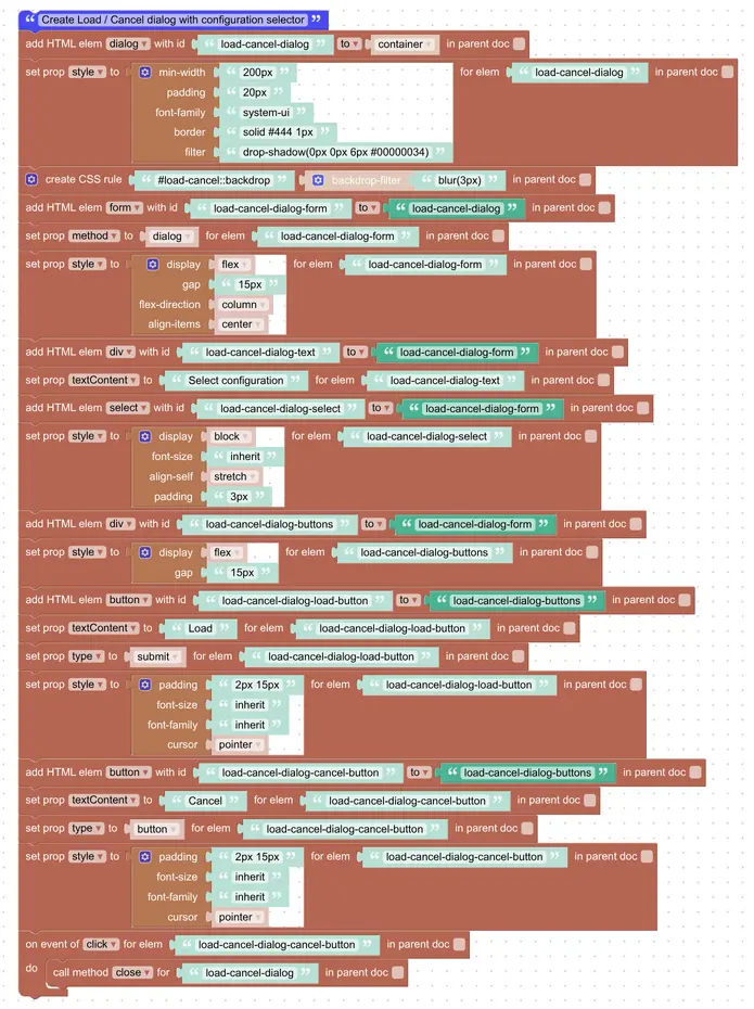

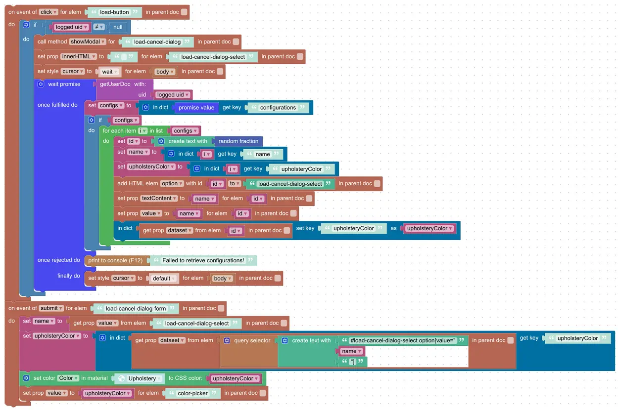

Loading configurations
The load-cancel-dialog contains a <select> element and two <button> elements. It is used to display the dialog for loading chair configurations obtained from the remote database:
Load dialog look
HTML Puzzles for creating load dialog

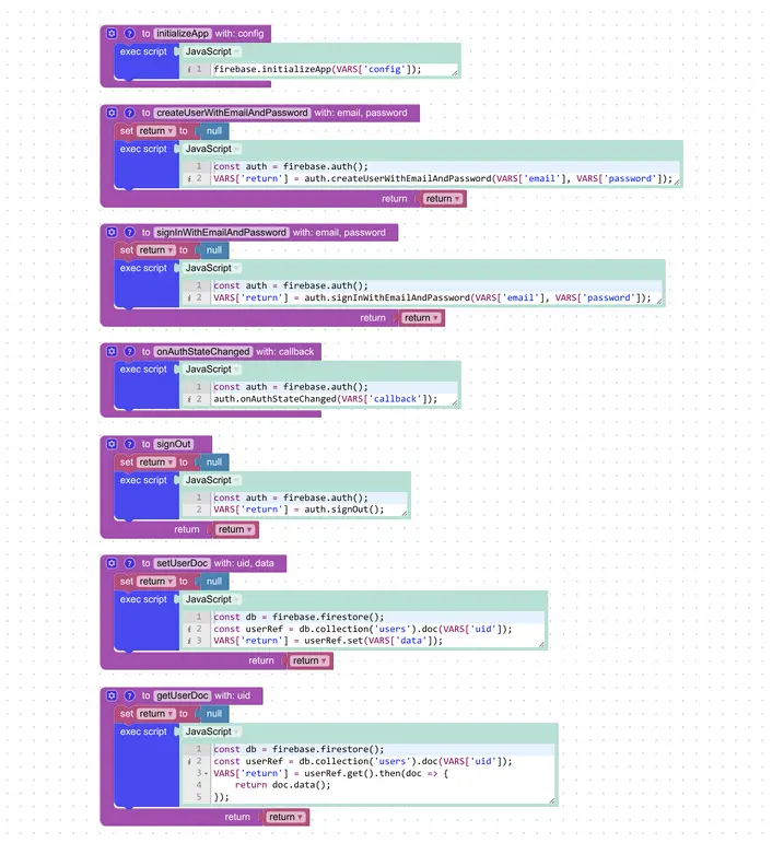

Firebase bindings
Firebase APIs are made for JavaScript (or other languages), not Puzzles. To convert the corresponding method calls from JavaScript to Puzzles you need to implement several bindings — in other words, connectors between Puzzles and code:
Firebase Puzzles bindings
For our configurator app we use the following methods:
  • initializeApp — initialize a Firebase app
  • createUserWithEmailAndPassword — create a new user with email and password
  • signInWithEmailAndPassword — sign-in with email and password
  • onAuthStateChanged — handle authentication status changes
  • signOut — sign-out from the account
  • setUserDoc — set a document in the Firestore database
  • getUserDoc — retrieve a document from the Firestore database
Implementing these in your own Firebase app might be cumbersome, so you better copy-paste them from the freely available project sources.

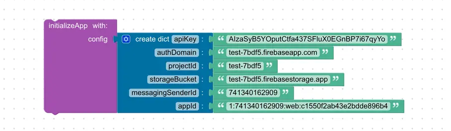

App initialization
Once you create a Firebase app, it will provide the configuration which looks as follows:
const firebaseConfig = {
  apiKey: "AIzaSyB5YOputCtfa437SFluX0EGnBP7i67qyYo",
  authDomain: "test-7bdf5.firebaseapp.com",
  projectId: "test-7bdf5",
  storageBucket: "test-7bdf5.firebasestorage.app",
  messagingSenderId: "741340162909",
  appId: "1:741340162909:web:c1550f2ab43e2bdde896b4"
This configuration should be passed as a dictionary value into the initializeApp API method:

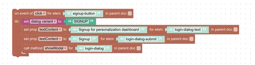

Showing signup dialog
Here we register the click event listener for the "Signup" button with the on event of puzzle. Once the user clicks on that button, we set the dialog variant variable to "SIGNUP" (we'll use it later), set dialog text, set text for the dialog's submit button, and finally display the actual dialog with the call method - showModal puzzle.
Puzzles to show signup dialog

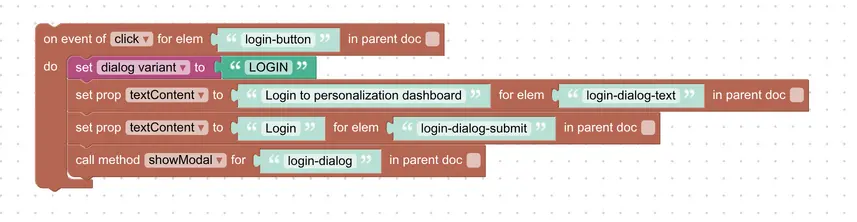

Showing login dialog
Here we register the click event listener for the "Login" button with the on event of puzzle. Once the user clicks on that button, we set the dialog variant variable to "LOGIN" (we'll use it later), set dialog text, set text for the dialog's submit button, and finally display the actual dialog with the call method - showModal puzzle.
Puzzles to show login dialog

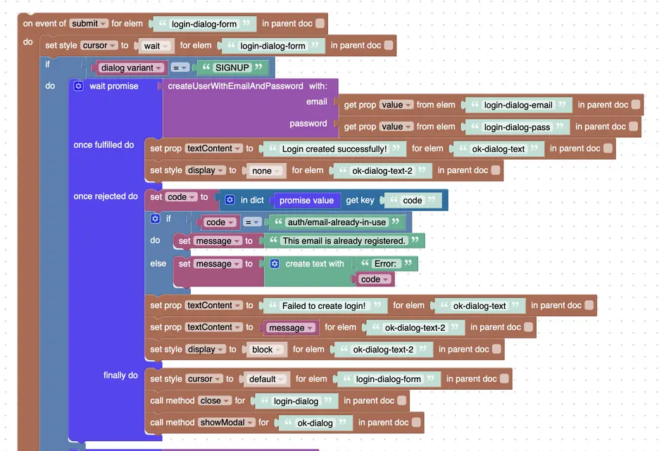

Processing signup
As we stated earlier, we use the same dialog for signup and login. The actual behavior is managed by the dialog variant variable.
Our common processing logic starts with the on event of puzzle used to handle the submit event of the dialog form. In the beginning we also change our cursor to a waiting symbol with the set style puzzle.
Puzzles to process signup
The SIGNUP part of the event collects the user credentials from the form and executes the createUserWithEmailAndPassword API method. This method returns a promise value that should be waited for.
What happens next depends on whether the sign-up process finishes with success or error. In both cases we set the corresponding message as the first text line of the ok-dialog dialog (ok-dialog-text). In case of error, we additionally extract the error code from the resolved promise to set an error message for the second line of the dialog (ok-dialog-text-2) and display it to the user (set style → display → block).
Finally, we return the mouse cursor back to normal, close our login dialog and open the ok dialog.

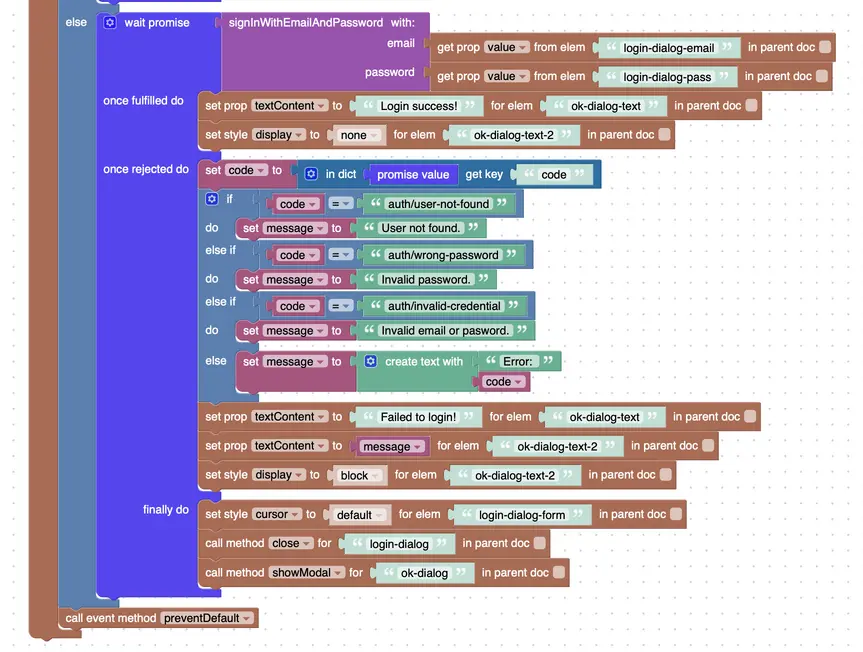

Processing login
This is the second half of our submit event handler:
Puzzles to process Firebase login
This part is responsible for managing the LOGIN variant of our dialog. Similarly to the first part, it collects the user credentials, but this time executes the signInWithEmailAndPassword API method.
In this snippet we do not use the returned user information (except for handling errors), since the actual login status modification is processed by the onAuthStateChanged (see below).

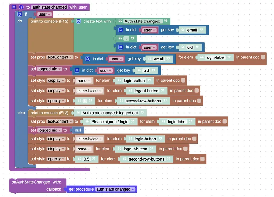

Listening for auth state changes
Firebase offers a really convenient method called onAuthStateChanged.
Puzzles to handle Firebase auth state change
It listens for changes to the user's sign-in state in real time calling the provided callback procedure. For example, it may be used to automatically restore the login session upon the app reloading.
The auth state changed callback procedure takes the user info object as its parameter and does the following:
  1. Checks if the user object is defined or null. Defined means the user just successfully logged in, while the null value means he just logged out
  2. Updates the login-label text field
  3. Sets logged uid variable with the current user ID
  4. Swaps the "Login" and "Logout" buttons (as we discussed earlier, only one of them can be visible at once)
  5. Makes the second row of buttons ("Save" and "Load") opaque or semi-transparent. Semi-transparent buttons appear disabled, so the user won't click them mistakenly if not logged in

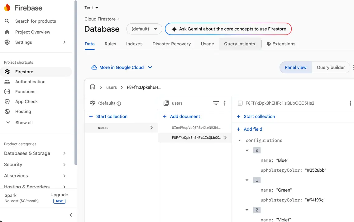

To save/restore configurations we use the remote database called Firestore. Firestore is a powerful, fast, yet really easy-to-use database that is available from any Firebase project (hence the similarity between the two names). This database stores documents which are very similar to Puzzles' dictionary values (do not confuse these with Word or Excel documents).
Documents are stored/retrieved to/from the database by their IDs (unique strings, e.g. "miJebfFBqNa4QCJWyeV1"). Also, the Firestore documents are grouped into collections (this is mandatory, each document must be an item of some collection, e.g. "users").
In our Chair configurator app we store configurations on a per-user basis. For document ID we use the user's unique ID obtained during authentication (it is stored in the logged uid global variable). The document looks as follows:
  configurations: [
      name: "First Configuration",
      upholsteryColor: "#RRGGBB"
      name: "Second Configuration",
To see how your database looks like, go to Project → Databases & Storage → Firestore in your Firebase console:
Firestore admin UI
Don't worry if you make mistakes in your app. You can always cleanup the entire database and start from scratch.

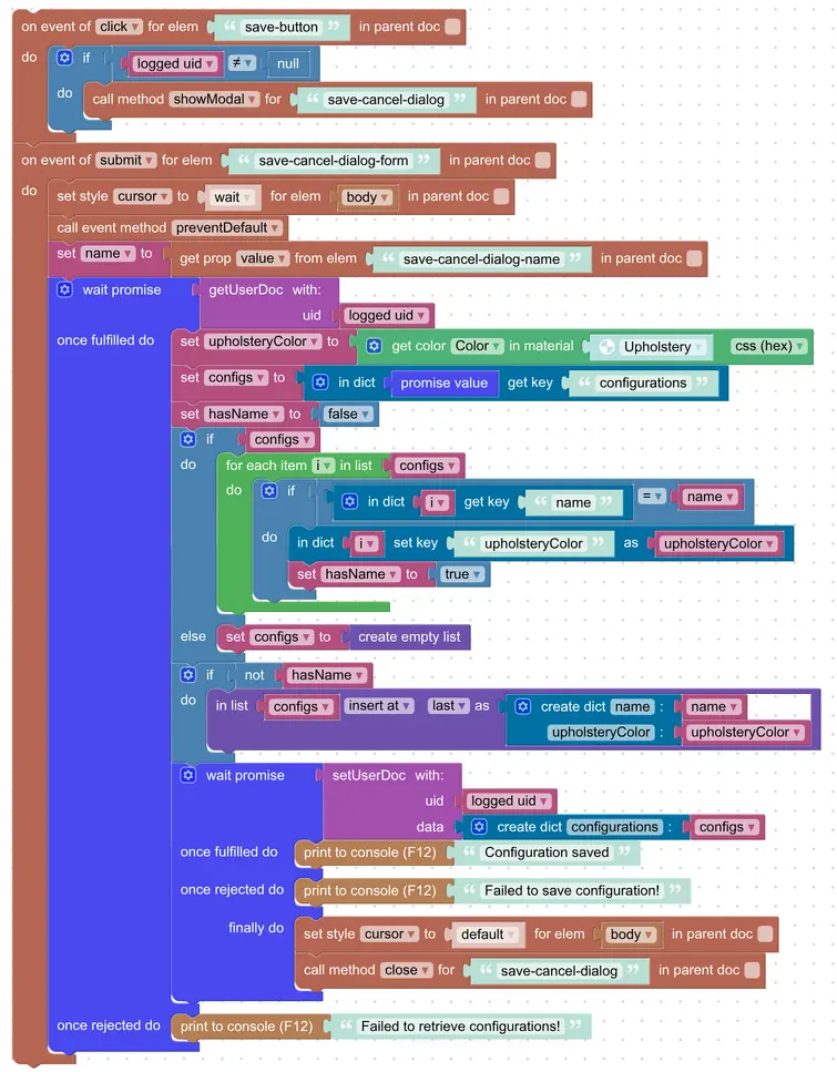

Having designed the database structure we can proceed to the actual Puzzles to store the user's configuration.
Puzzles to save configuration
Let's explain this scenario step by step.
In the beginning we use the usual pair of puzzles on event of and call method to show the save-cancel-dialog dialog:
Save dialog look
Then the user clicks on the "Save" button, the submit event is sent to the save-cancel-dialog-form form. In the event handler we do the following:
  1. Change cursor to a waiting symbol as communicating with the remote server takes time
  2. Prevent the form submission. For dialog-based forms this means the dialog won't be closed immediately.
  3. Retrieve the current configuration name
  4. Execute the getUserDoc method to retrieve the document associated with the user ID
  5. Retrieve the configurations key (aka field) from the document and save it to the list represented by the configs variable (remember, the document structure is represented by a dictionary)
  6. If the configurations list is present, we try to find an existing item with the name equal to the saved name. If the configurations list is not present, we create an empty one.
  7. If the saved name item is present in the list, we set the upholsteryColor for the corresponding item
  8. If the saved name item is not present in the list, we create a new item (also a dictionary) and set its name and upholsteryColor keys
  9. The configurations list is ready, so we create a new document and execute the setUserDoc method to store it in the remote database
  10. Finally, we return the cursor style back to normal (set style → cursor → default) and close the dialog
Logic for loading configurations consists of two important snippets:
  1. When the user clicks on the "Load" button from the top-left corner of the app, we open the "Select Configuration" dialog, retrieve the configurations from the database, then populate the dialog's option selector
  2. When the user clicks on the "Load" button from the dialog (do not confuse it with the previous "Load" button), we assign the selected upholstery color on our Chair model
Puzzles to load configuration
The first step is similar to how the getUserDoc method was used during the saving stage. The difference is that instead of updating the configs list we fill the dialog's <select> element with options.
Each option is represented by the <option> element with the value property set to the corresponding configuration name. The option's color is stored in the dataset property as a CSS color (e.g. #ff0000 for red)
On the second step we retrieve the active <option> element with the query selector puzzle, extract color from its dataset property, then apply the extracted color to the model with the set color puzzle. We also update color-picker with the same color value.

  1. Enable email/password authentication with Project → Security → Authentication → Get started
  2. Create a Firebase database with Project → Databases & Storage → Firestore → Create database (select all options by default)
  3. Append the Firestore security rules (e.g. by copying/pasting the contents of the firestore.rules file) with Project → Databases & Storage → Firestore → Rules
