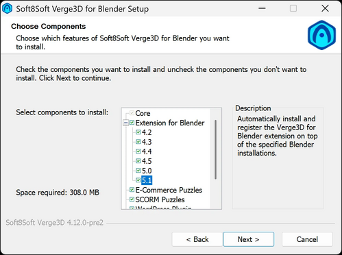

For Windows, specify the required version right in the Choose Components section of the installer:
