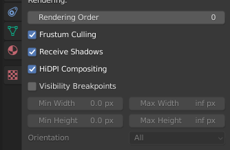

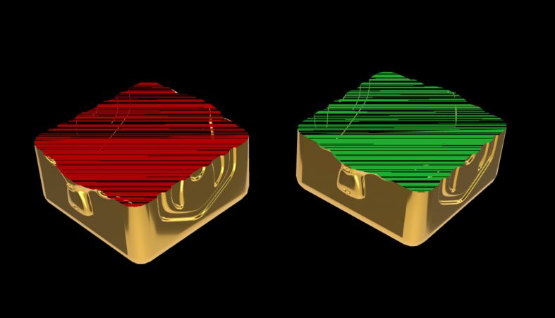

HiDPI composing is a nice feature to render some of your objects in high quality:
However, this feature has some limitations:

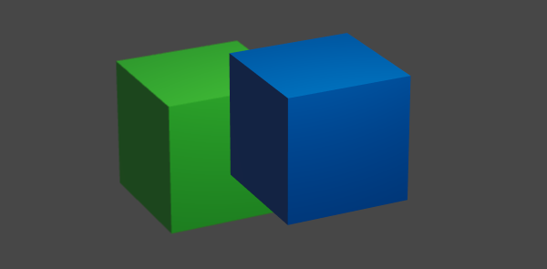

  • HiDPI objects can not be influenced by the depth of the objects rendered before them, as such there might be artifacts similar to these (green - regular object, blue - HiDPI object):
So, HiDPI works fine for UI and camera-parented objects only.

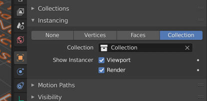

Deep Collection Instancing
In general, you can link collections to your blend file via instancing, and this is supported in Verge3D:
However, you can not nest instanced collections, e.g it's not possible to instance collections which in turn included in other instanced collections and so on.

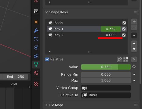

Partial shape keys (morphing) animation
You should animate meshes with shape keys (morphing) as a whole, not partially. E.g the following won't work:
To fix the issue, you should add at least one keyframe to "Key 2".

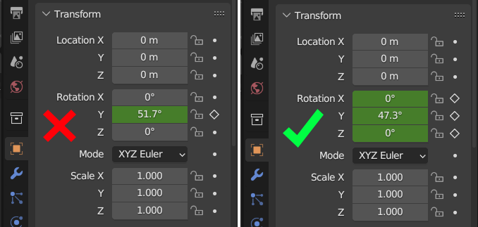

Rotation animation
Rotation animation must be on all axes, otherwise there may be unpredictable results.

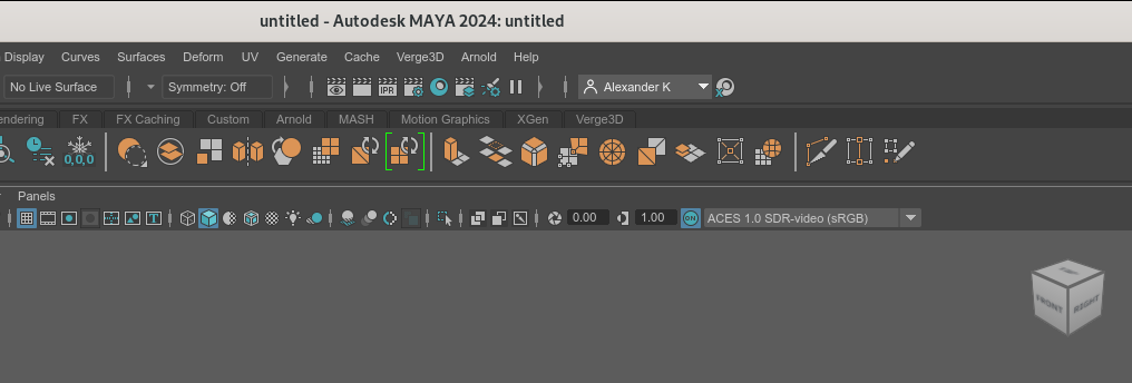

View Transform
Default ACES 1.0 SDR-video (sRGB) view transform is not supported, which makes Verge3D scenes look different from Maya viewport.
Always switch to sRGB gamma view transform to get consistent results. See here for more info.
