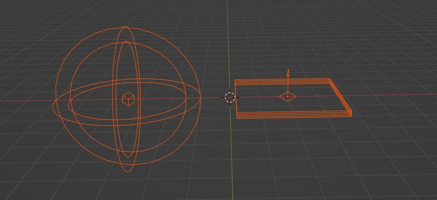

Get rid of light probes
Reflection cubemaps affect loading speed, while planes affect both loading speed and rendering performance. Both consume extra GPU memory.

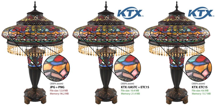

Use ETC1S compression for all textures
You'll surely get some artifacts with this compression algorithm, but the memory and network bandwidth savings are truly enormous. Just check this lamp out sampling courtesy of Khronos:
The instructions are here.
