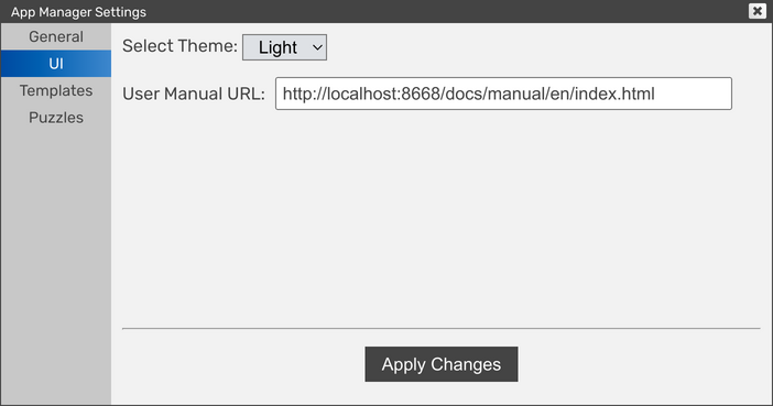

Assign proper version of the User Manual
By default, Verge3D uses the up-to-date version of the User Manual which is available online. What you really need is the version that comes bundled with your outdated Verge3D distribution. Do do so, switch the User Manual URL in App Manager's settings to:
- http://localhost:8668/docs/manual/en/index.html — for Verge3D for Blender
- http://localhost:8669/docs/manual/en/index.html — for Verge3D for 3ds Max
- http://localhost:8670/docs/manual/en/index.html — for Verge3D for Maya
