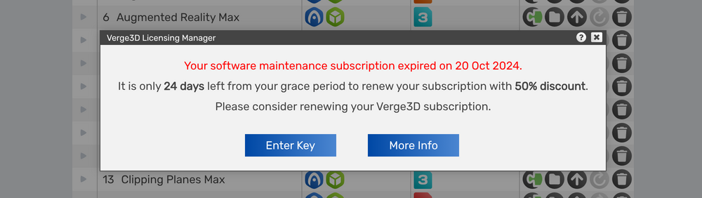

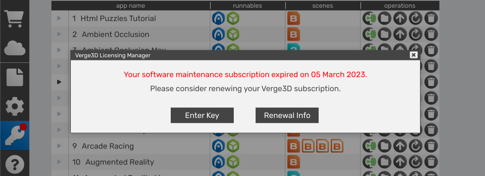

Verge3D is constantly updated, so it's beneficial for you to use the latest version still available for your license term. How to find which version it is? Easy! Just go to the license manager by clicking the "key" icon in the App Manager.
It will display the expiration date. Then go to the download archive and find the version released before that date. For example, if the subscription expired on 20 October 2024, the last version available for you would be Verge3D 4.7.1 (released on 5 August 2024).
