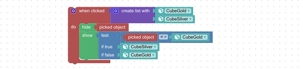

Swapping object on click
Say you need to replace some object by another one given they both occupy the same place, e.g swap CubeGold by CubeSilver and vice versa. Most evident way would be using two when clicked puzzles:
This won't work however since both events happen right after another. So the first event handler will switch to CubeSilver, then the second will switch back to CubeGold.
A possible workaround could be delaying the actions by one render frame:
Alternatively, you could swap your objects using just one when clicked puzzle:

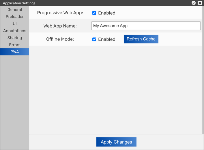

Forgetting to refresh cache in offline mode
Once you activate the Offline Mode in the App Manager settings, a persistent app cache will be created and populated on the first launch.
This cache will be reused for all subsequent launches of your app so if you make any changes to it, they won't apply. You can either press Refresh Cache each time you make changes or, which is better, keep Offline Mode disabled during the app development (and only enable it when the app is ready).

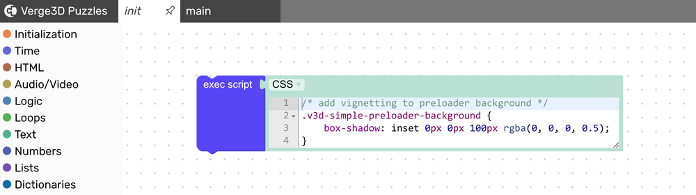

Adding custom CSS code with exec script
If you need to add custom CSS code to your application, the exec script won't do the job, since CSS is not a scripting language. Basically, the following puzzle will fail with syntax error (thinking the passed text is a piece of JavaScript):

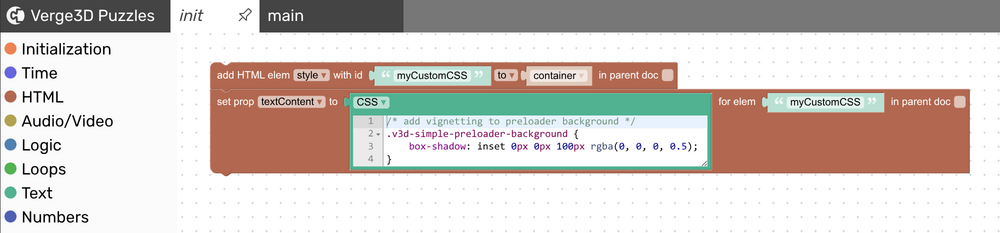

Instead, you should create a new <style> element and insert your custom CSS code as its textContent property:
Upon adding this element to the page (e.g. to the canvas container), the browser will automatically apply the CSS style and modify the look of your page.
