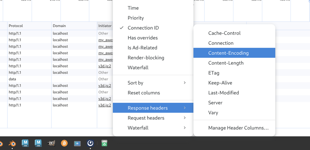

To check whether asset compression is working, open Chrome/Edge console (F12), then go to the Network tab. Right-click the table header and enable Response headersContent-Encoding.
Enabling Content-Encoding column in Chrome/Edge devtools

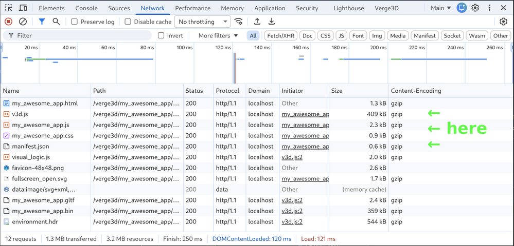

Reload your page. Assets with compression will have gzip in the Content-Encoding column:
Checking server asset compression in Chrome/Edge
Note that some files should not be compressed by the server as they store data in compressed form already. These include: .png, .jpeg, .webp, .mp3, .xz, .woff among others.
