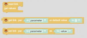

Puzzles:
Puzzles: read link
Puzzle for convenient organization of reading the link parameters and subsequent launch of the main init function.
Puzzles: get link parameter
Get a link parameter by it mane or use provided default value, if the link does not contain the specified parameter. You can use it directly or assign it to a variable.
Puzzles: set link parameter
Saves the passed variable or the value in the user-specified parameter in the link to the reference. The parameter will be created if it does not exist, or will be updated if it already exists. It keeps original parameters order, so if you want to organize parameters in link just place this puzzles in desired order and then if you change one of parameters, it will keep its position in the link.
