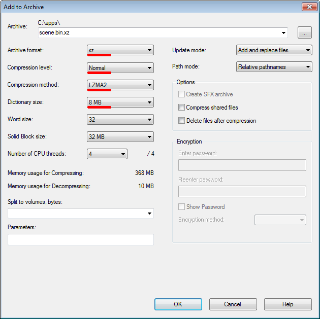

To compress a file you can right click it, and then choose "7-Zip" → "Add to archive..." — this opens the corresponding dialog window:
The archivation settings should look like this:
  • Archive format: xz
  • Compression level: any (Normal, Maximum and Ultra give best results)
  • Compression method: LZMA2 (the only available option)
  • Dictionary size: up to 8 MB - the more the better (more than 8MB is not supported by the engine)
  • The rest of options can be left by default.
