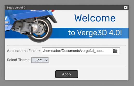

Puzzles Library
The Puzzles library is now stored inside the applications folder (selected on first launch):
So you should copy the file called my_library.xml from e.g. verge3d_blender/puzzles of your old Verge3D 3.X installation to your new applications folder.
