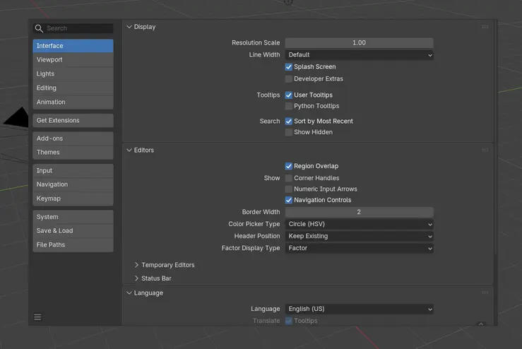

Known Bugs
Missing window decorations — reported in Blender Issues and Chromium Bugs.
Missing windows decorations on Blender running on ChromeOS
