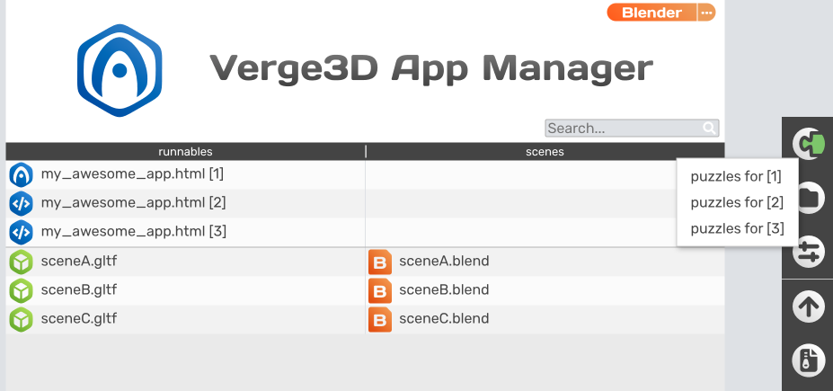

Open your app in the App Manager. You will see the following:
By clicking on the corresponding HTML, you will launch your app with the scene specified in HTML params file.
Running Puzzles on per-scene basis
Once you have your launchers assigned in html_params.json, click with right mouse button on the Puzzles icon on the app view screen. You will see the following items in the popup menu:
By clicking on the corresponding menu item, you will launch the Puzzles editor with the scene specified in HTML params file.

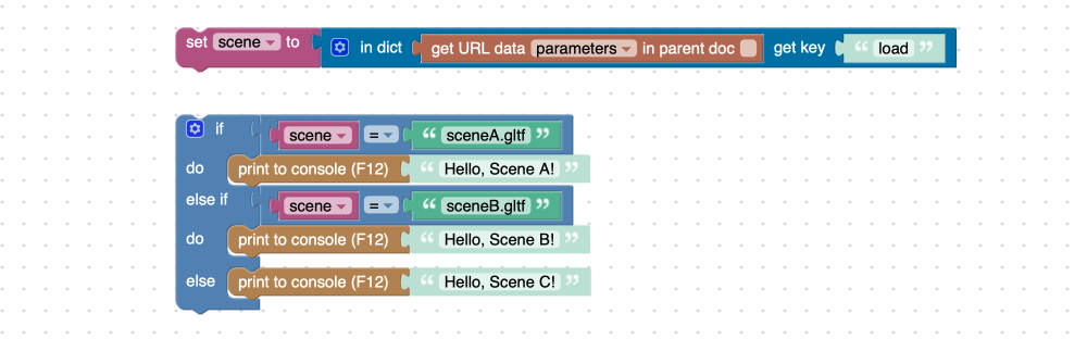

To execute different Puzzle blocks for different scenes, you might use the following snippet:

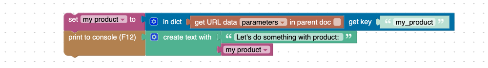

You can get values of URL params similarly to how you obtained the loaded scenes in the snippet above. For example to retrieve my_product, use the following Puzzles:
