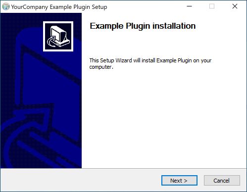

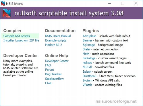

Launch NSIS, click Compile NSI scripts, then select setup.nsi script:
Done! Check out the EXE file generated along the plugin directory. Launch the installer to confirm it works correctly:
