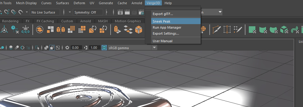

To make sure that Verge3D is installed correctly, you can render a basic model in the web browser by using the Sneak Peek menu option:
Sneak Peek menu in Maya
...or the button located on Verge3D shelf:
Sneak Peek shelf button in Maya
This function will perform an export to a temporary folder and will run the default web browser with interactive rendering. You may use Sneak Peek for quick tests any time you are working on your projects.

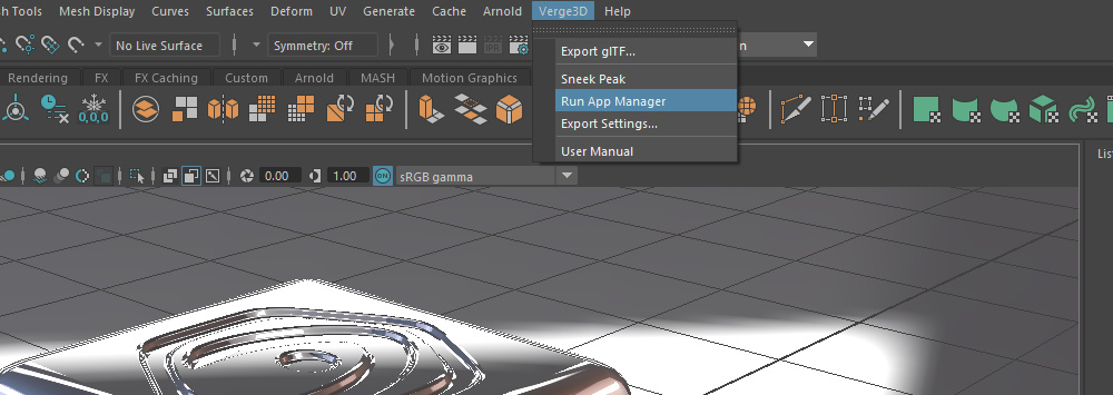

The App Manager opens up in the web browser when you select the Run App Manager option in the Verge3D menu (or click the corresponding shelf button).
Running app manager from Maya App manager shelf button in Maya

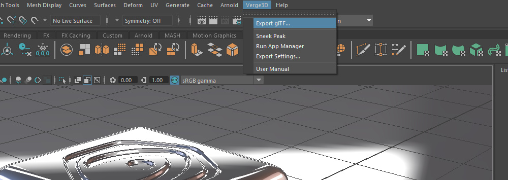

Exporting can be performed from the Verge3D menu of the main menu bar (or by using the corresponding shelf button). You might want to assign a shortcut for this operation since you may perform it quite often.
Exporting Maya scene to glTF App manager shelf button in Maya
Export your scene to the root of the corresponding application folder, in glTF format.

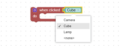

To do something meaningful for the beginning, drag out the when clicked puzzle from the Events category and select some object in the light-green dropdown.
Adding when clicked puzzle from the toolbox
This puzzle causes your app to wait until the user clicks on the specified object, and then do... nothing unless you add something in the do slot.
