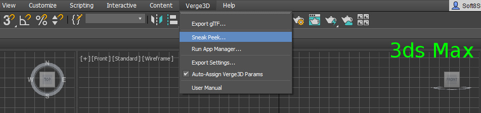

To make sure that Verge3D is installed correctly, you can render a basic model in the web browser by using the Sneak Peek menu option. This function will perform an export to a temporary folder and will run the default web browser with interactive rendering.
Sneak Peek button in 3ds Max
You may use Sneak Peek for quick tests any time you are working on your projects.

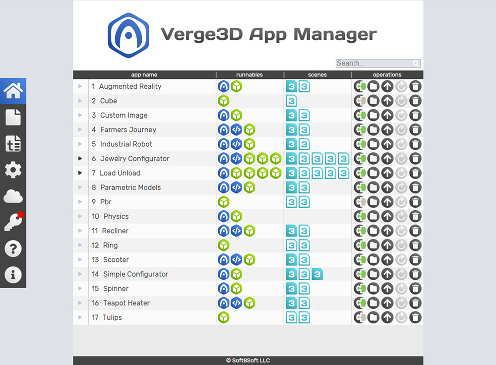

App Manager main screen

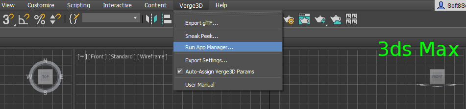

The App Manager opens up in the web browser when you select the App Manager option in the Verge3D menu. The default system browser will be running - you can change it in your OS settings. Any modern browser will work yet we recommend the latest version of Google Chrome which is fast, standards-compliant and offers good web development tools.
App Manager menu in 3ds Max

Once a new application is created, it will appear in the list.

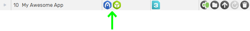

You can run your app any time by clicking the Verge3D icons, either the blue or the green one. The blue icon launches an app in its final form, with its Puzzles scenario and the programming code (if present). On the contrary, the green icon only opens the exported scene.
Buttons to run My Awesome App

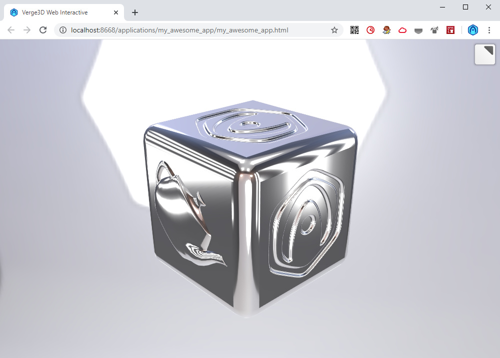

A freshly created app loads and displays just a cube. You can look around with the left mouse button pressed, and zoom in and out with the mouse wheel.
Running My Awesome App in the browser

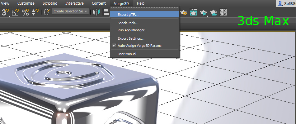

Exporting can be performed from the Verge3D menu of the main menu bar. You might want to assign a shortcut for this operation since you may perform it quite often.
Exporting 3ds Max scene to glTF

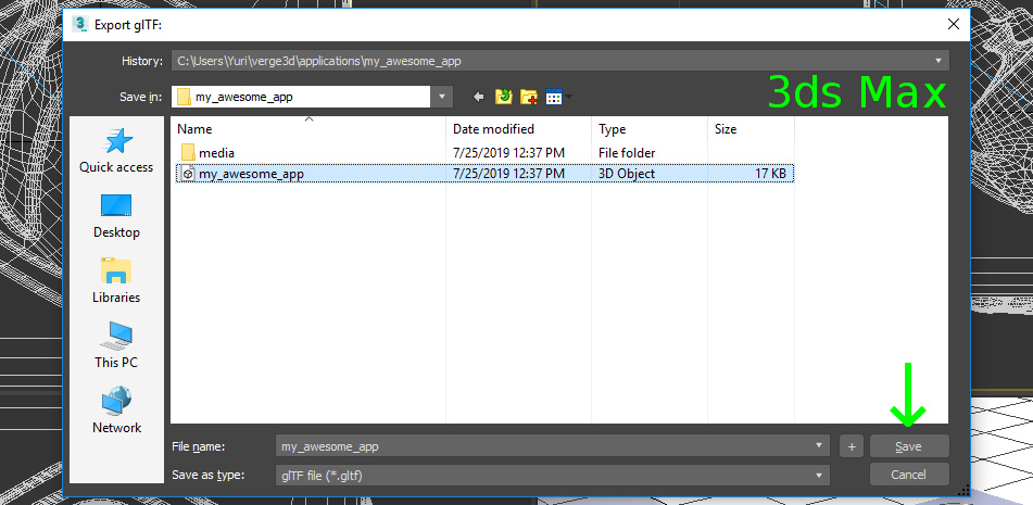

Export your scene to the root of the corresponding application folder, in glTF format.
Selecting name for exported glTF asset

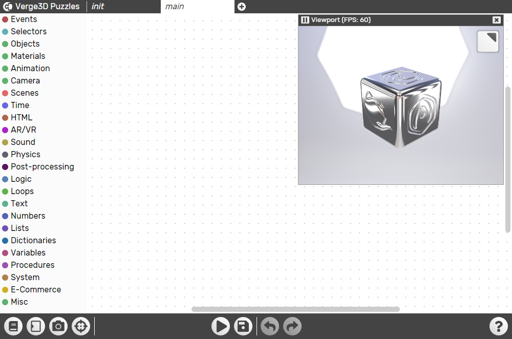

Click the Puzzles button near your app name in the App Manager. This will run your app with the Puzzles editor attached on top of it.
Puzzles editor screen

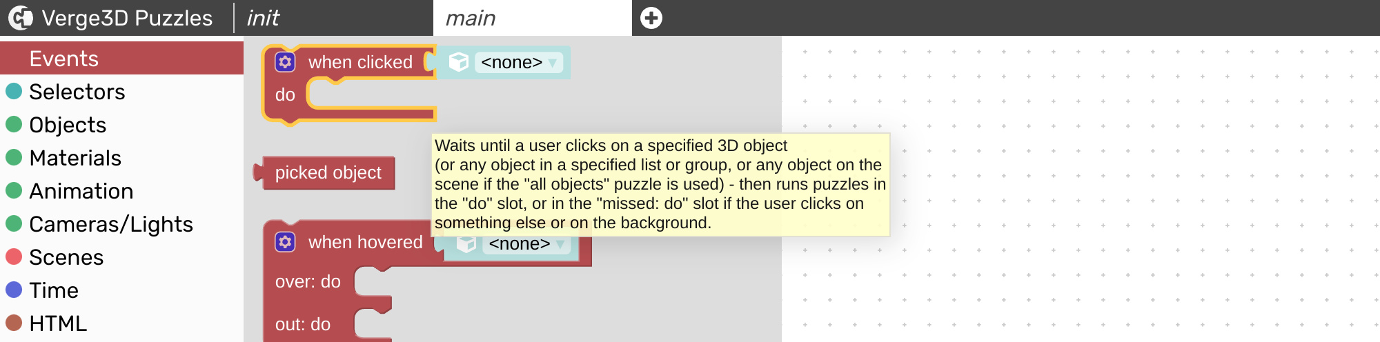

On the left the toolbox with some categories ("Events", "Selectors", "Objects", etc) is located. The categories are expanded upon mouse click revealing puzzles which you can drag out to the workspace. By connecting various puzzles with each other, you can create a scenario of how your 3D objects will behave upon user input.
You can quickly obtain help for any puzzle by hovering the mouse cursor over it or by using the right-click menu.
Puzzles toolbox
To do something meaningful for the beginning, drag out the when clicked puzzle from the Events category and select some object in the light-green dropdown.
Adding when clicked puzzle block from the toolbox
This puzzle causes your app to wait until the user clicks on the specified object, and then do... nothing unless you add something in the do slot.

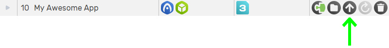

But what if you haven't had the chance to become a web master? No problem — by clicking a button in the App Manager you can upload your app to the Verge3D Network, a cloud-based storage and CDN hosted on Amazon servers.
Button to upload My Awesome App to Verge3D Network
After the uploading is complete, a screen will show up with a direct link which you can share by whatever means (in a blog post, social media, comments, email, you name it). It will also generate HTML code for embedding your app in third-party websites just like you do it with YouTube videos.

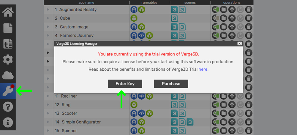

Activating License

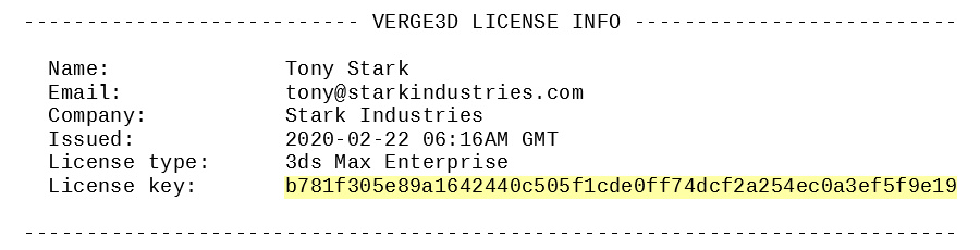

You can take the trial for a spin for an indefinitely long period of time. However, for use in production you will need a license. The license information is sent via email (the key below is a random example).
E-mail with Verge3D license key Activating Verge3D for 3ds Max license
The license key will activate your Verge3D instance and will remove the trial watermark from all your apps.
