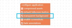

The plugin needs to enable transparency background. In the init tab, check the transparency background option of the configure application puzzle.

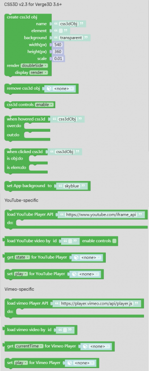

create css3d object
The puzzle is used to create a new CSS3D object. A CSS3D object consists of a Plane object and an HTML DOM element. Css3d-2(1).png Parameters:
  • name: the name of the CSS3D object
  • element: the 'HTML DOM' element to embed (e.g '< div >' < iframe > '< img >')
  • background: the background of the CSS3D object, default is 'transparent'
  • width(px): the width of HTML DOM element and the Plane object, in pixels
  • height(px): the heiht of HTML DOM element and the Plane object, in pixels
  • scale: Scaling factor, which controls only the scaling of the Plane object
  • render: Rendering mode - 'frontSided' or 'doubleSided'
  • display: Display mode - render, solid, wireframe
If you want to embed Bilibili, youtube and Vimeo videos into 3D scene, you only need to copy the video embed code into the element parameter.

remove css3d object
css3d controls
This puzzle is used to control whether the embedded web page interaction is enabled or not.
Option:
  • enable:enable interaction
  • disable: disable interaction
when hovered css3d
Add 'hover' event listener to css3d object. When the pointer moves in, execute the puzzles in the over:do slot; When the pointer moves out, execute the puzzles in the out:do slot. Do not support group, object list and all object puzzle.
when clicked css3d
Add 'click' event listener to CSS3D object. Because a CSS3D object consists of a Plane object and an HTML DOM element. When you click on a CSS3D object, the target may be a Plane object or an HTML DOM element. When it is a Plane object, execute the puzzles in the is obj:do slot; When it is an HTML DOM element, execute the puzzles in the is elem:do slot. Do not support group, object list and all object puzzle.

set app background
set verge app's background, support CSS style string, such as #AA00FF.

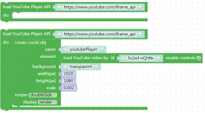

load YouTube Iframe API
Enable 'YouTube Iframe API' for the CSS3D object embedded YouTube video. It is used to control the video playback outside the YouTube player. Once the API loaded, the puzzles in the "do:" slot will be executed. You can use the create css3d obj puzzle here to create a new YouTube player.
load YouTube Video
Load video by the ID of the YouTube video. enable controls controls whether the player control is displayed. Default is off. Used on the element parameter of the create css3d obj puzzle.
get YouTube player prop
Returns the property of the player:
  • state: Returns the state of the player. Possible values are:
    • -1 – unstarted
    • 0 – ended
    • 1 – playing
    • 2 – paused
    • 3 – buffering
    • 5 – video cued
  • currentTime: Get the playback position of a video
  • volume: Get the volume level of a player
  • isMuted: Get whether the player is muted
  • duration: Get the duration of a video
YouTube Player playback Controls
Playback control of YouTube player.

load Vimeo Player API

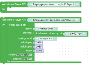

Enable 'Vimeo Player API' for the CSS3D object embedded Vimeo video. It is used to control the video playback outside the Vimeo player. Once the API loaded, the puzzles in the "do:" slot will be executed. You can use the create css3d obj puzzle here to create a new YouTube player.
load Vimeo Video
Load video by the ID of the Vimeo video. enable controls controls whether the player control is displayed. Default is off. Used on the element parameter of the create css3d obj puzzle.
get Vimeo Player prop
  • currentTime:Get the playback position of a video
  • duration:Get the duration of a video
  • loopState:Get the loop state of a player
  • paused:Get the pause state of a player
The puzzle returns a Promise (opens new window)object, you should use the wait promise (opens new window)puzzle in Advanced category to get the value.
Vimeo Player playback Controls
