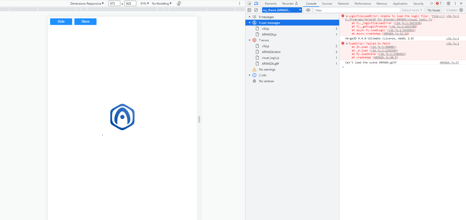

    The Index html file and the project file on the local device do not start. The launch takes place only through the App Manager. When you simply open the project file from the root folder, a download window appears and error data, as in the screenshot. What could have gone wrong? Everything worked fine yesterday.
    #19255
    this is quite normal, see here: https://www.soft8soft.com/docs/manual/en/introduction/FAQ.html#app_browser_security
    #19256
    Участник
    что любопытно, он утверждает, что «вчера работало», хотя не должно было в принципе даже в Firefox :scratch:
