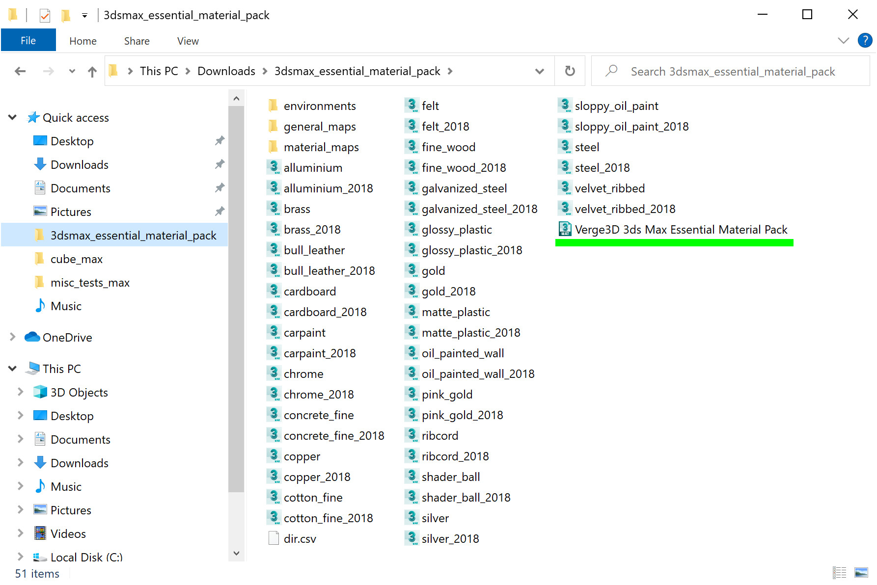

Simply unzip the archive with a library pack to any folder on your computer. Inside this folder you can find a main .mat file which represents the material collection. There are also numerous .max files (one per material), however in most situations you don't need to touch them.
![Content of 3ds Max material library](files/mat-library-max/library-contents.jpg)
The textures used in the materials are located in the material_maps folder. The folder environments contains 3 variants of HDR images that you can use for the environment (each variant comes in 3 resolutions: 1k, 2k and 4k).

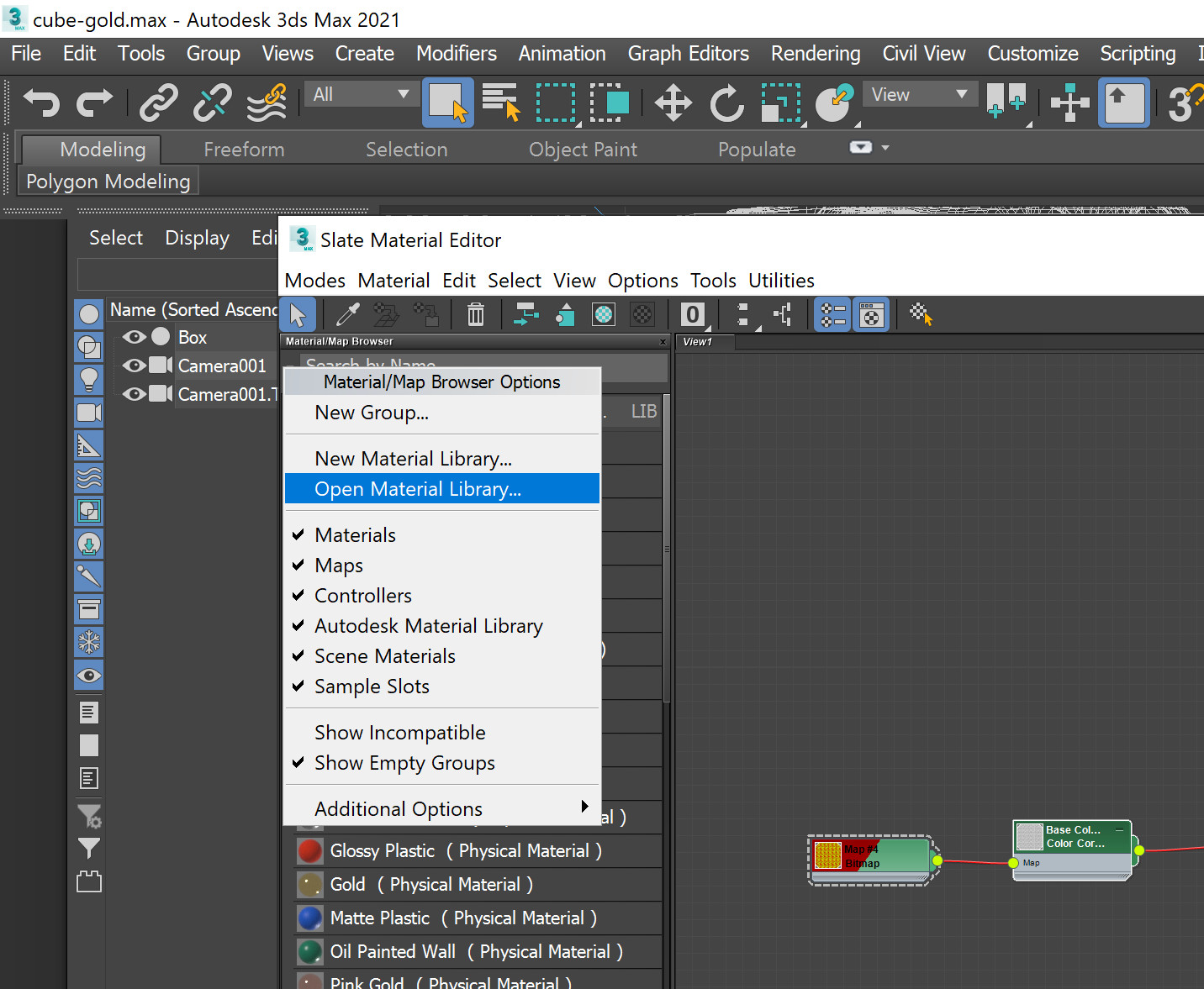

In order to use a library material in a project, invoke the Open Material Library... option in the Material/Map Browser:
![Opening 3ds Max Material Library](files/mat-library-max/open-material-library.jpg)

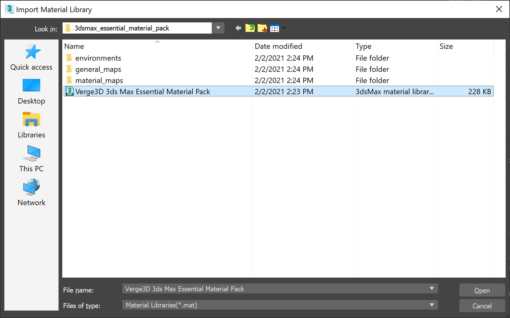

Then navigate to the library folder, select Verge3D 3ds Max Essential Material Pack.mat file and click Open:
![Importing material library to 3ds Max](files/mat-library-max/import-material-library.jpg)

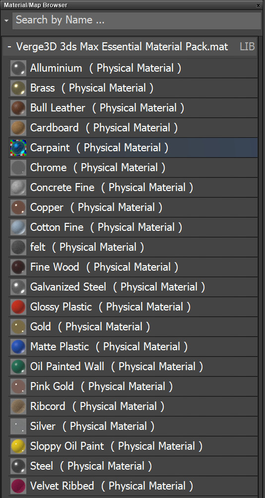

The list of materials should appear in the Material/Map Browser:
![Material/Map browser in 3ds Max](files/mat-library-max/essential-material-pack-list.jpg)

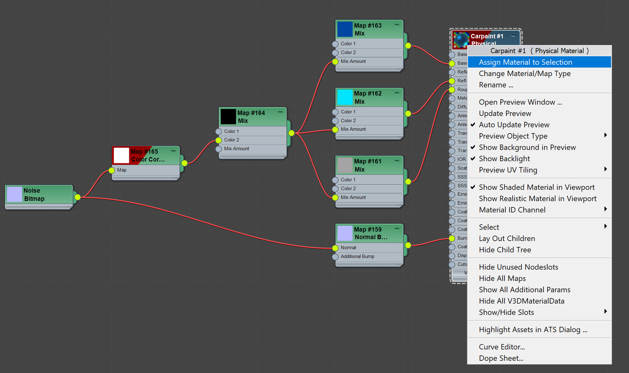

To assign any of these to a model, select a model, then drag material to the View area, then click on the material by using right mouse button, then select Assign Material to Selection:
![Assigning 3ds Max Material](files/mat-library-max/assign-material.jpg)

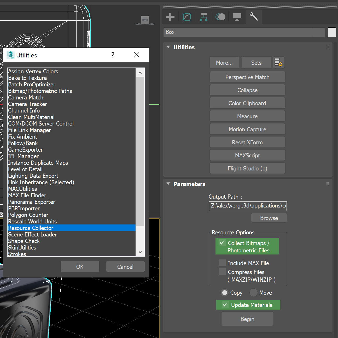

Open the Resource Collector utility, then specify path to your project. Make sure that Collect Bitmaps is checked, also enable the Update Materials option. Collect your files by clicking on the Begin button:
![Using 3ds Max Resource Collector](files/mat-library-max/resource-collector.jpg)
You can check the integrity of your application by moving its folder to another location in your file system. Open the max file and make sure no errors with missing assets are generated.
