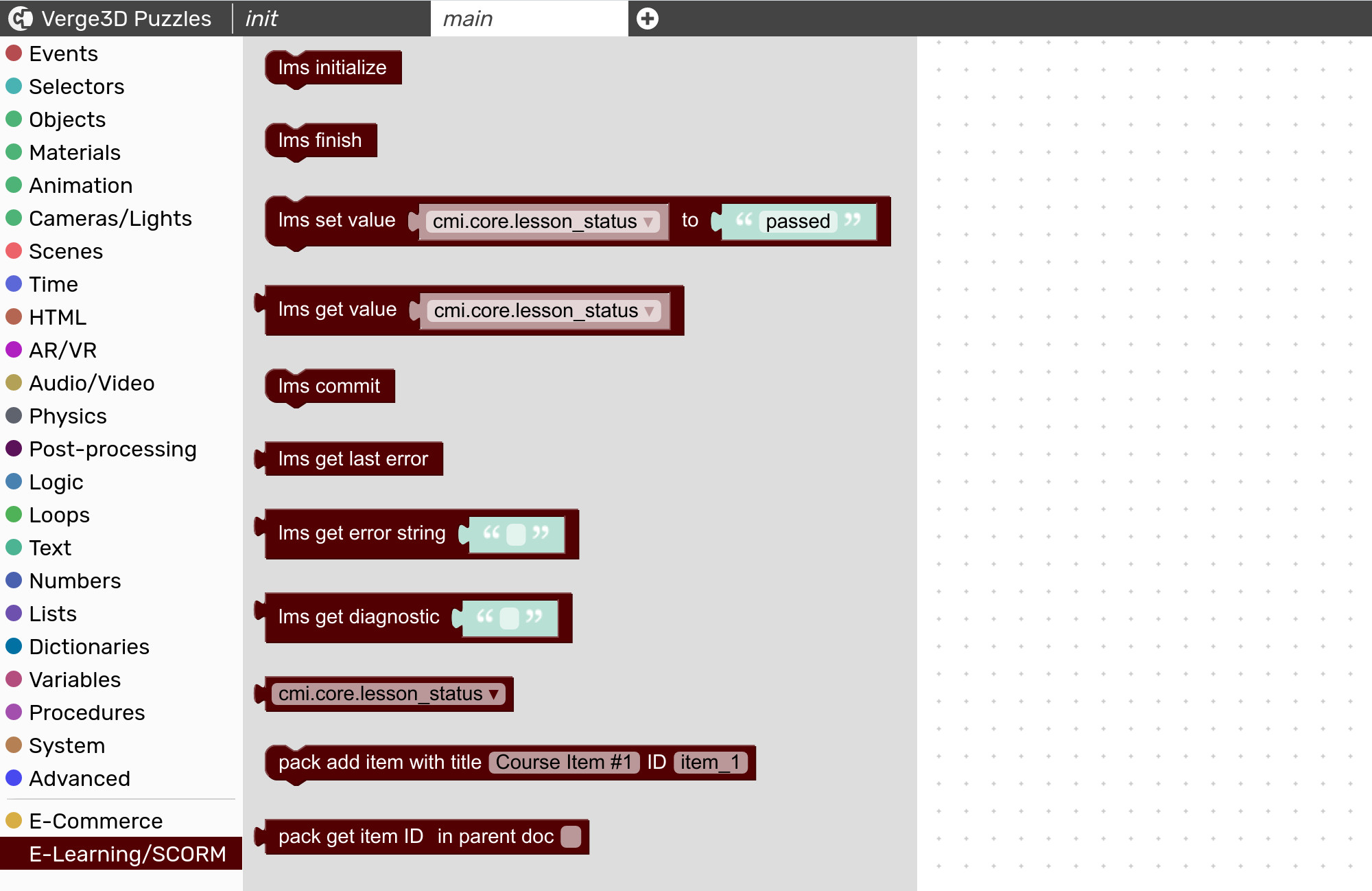

E-Learning/SCORM Plugin
This stock plugin adds puzzles that can be used for implementing SCORM-based e-learning applications. The plugin supports version 1.2 of the SCORM standard.
For more information on creating SCORM courses check out the corresponding section of this User Manual.
Contents
Puzzles Reference

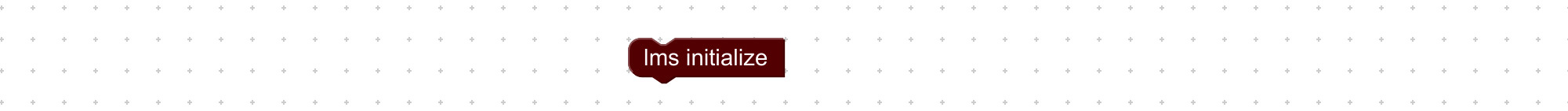

lms initialize
Start a communication session with the LMS (learning management system).

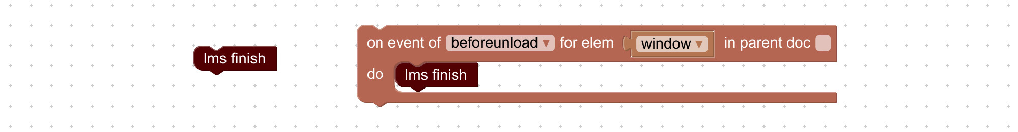

lms finish
Close a communication session with the LMS. You can exec this puzzle any time when you done communicating, however it's better to include it in the "beforeunload" event handler.

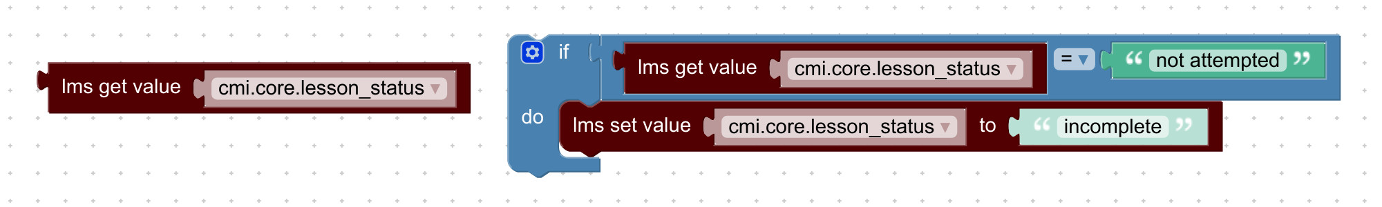

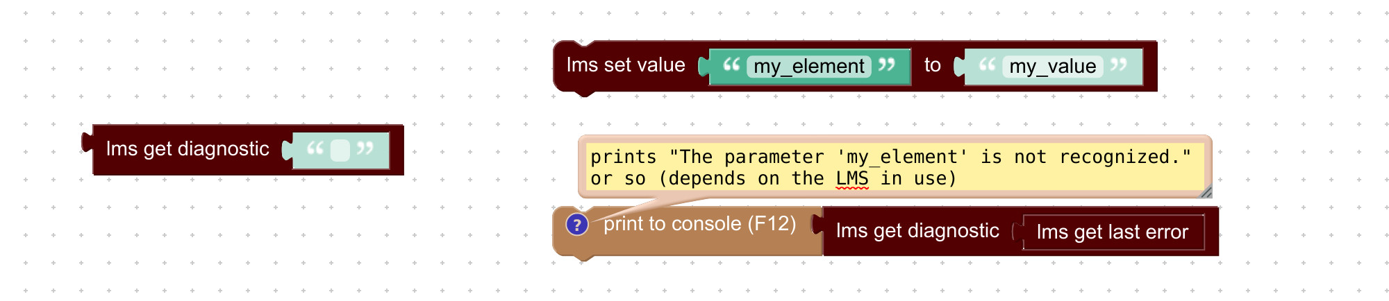

lms set value
Set a value for the given LMS element.
lms get value
Retrieves a value from the LMS element.

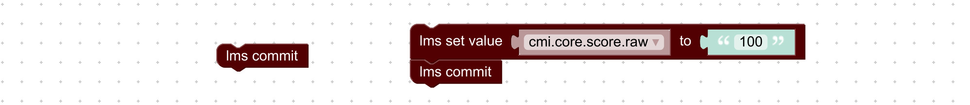

lms commit
Report to LMS that it should sync data received by the lms set value puzzle. Executing commit is not strictly required, however it can increase responsiveness of the UI in some LMS. For example, the Moodle LMS updates scores and lesson status upon commit.

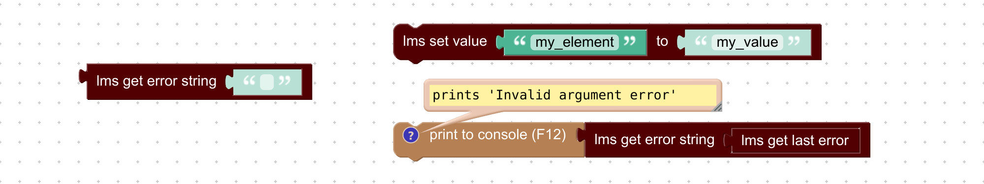

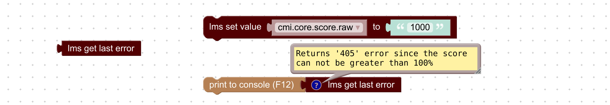

lms get last error
Returns the error code (encoded as string) that resulted from the last communication with LMS. The "0" value indicates that there is no error happened.
lms get error string
Returns a short string describing the specified error code.
lms get diagnostic
Returns detailed information about the last error that occurred.

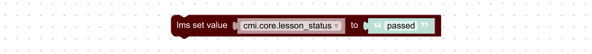

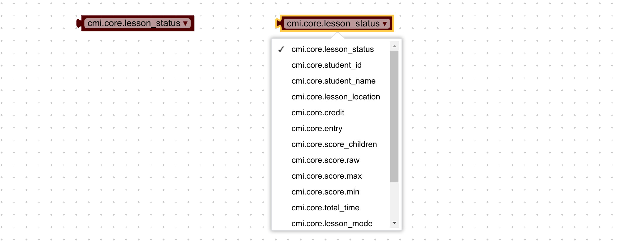

data model elements
List of the data model elements which can be assigned/retrieved by the SCORM package.
In SCORM terminology, "element" is just a parameter which is send to/received from the LMS. It has nothing to do with "HTML elements".
| Element | Read/Write | Description |
| cmi.core.lesson_status | Read/Write | Indicates whether the learner has completed and satisfied the requirements for the SCO. One of "passed", "completed", "failed", "incomplete", "browsed", "not attempted". |
| cmi.core.student_id | Read Only | Identifies the student on behalf of whom the lesson was launched. |
| cmi.core.student_name | Read Only | Name provided for the student by the LMS. |
| cmi.core.lesson_location | Read/Write | The learner’s current location in the lesson. |
| cmi.core.credit | Read Only | Indicates whether the learner will be credited for performance in the lesson. One of "credit", "no-credit". |
| cmi.core.entry | Read Only | Asserts whether the learner has previously accessed the lesson. One of "ab-initio", "resume", "". |
| cmi.core.score_children | Read Only | Listing of supported data model elements. |
| cmi.core.score.raw | Read/Write | Number that reflects the performance of the learner relative to the range bounded by the values of min and max. |
| cmi.core.score.max | Read/Write | Maximum value in the range for the raw score. |
| cmi.core.score.min | Read/Write | Minimum value in the range for the raw score. |
| cmi.core.total_time | Read Only | Sum of all of the learner’s session times accumulated in the current learner attempt. |
| cmi.core.lesson_mode | Read Only | Identifies one of three possible modes in which the lesson may be presented to the learner. One of "browse", "normal", "review". |
| cmi.core.exit | Write Only | Indicates how or why the learner left the lesson. One of "time-out", "suspend", "logout", "". |
| cmi.core.session_time | Write Only | Amount of time that the learner has spent in the current learner session for this lesson. |
| cmi.core._children | Read Only | Listing of supported data model elements. |

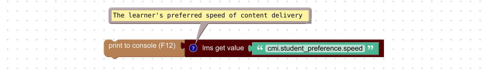

For simplicity, this puzzle includes only "core" elements. If you need to pass other (including non-standard) elements to lms set value/lms get value, use the text puzzle:

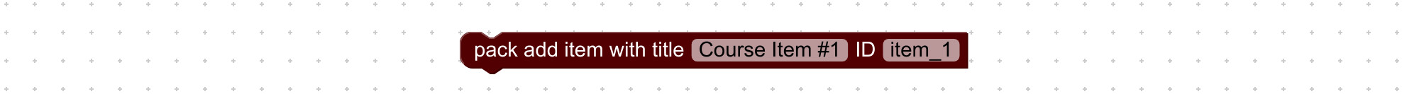

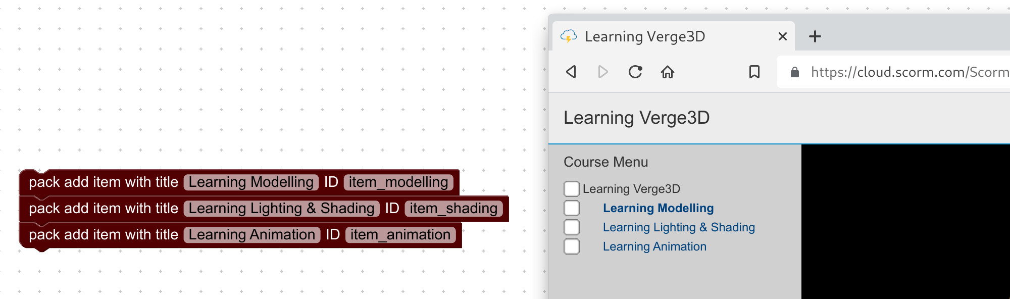

pack add item
Add an item to the manifest of the generated SCORM pack.
This puzzle is useful for creating multi-page courses which can run different content depending on the selected item.
To retrieve the current item ID use the pack get item ID puzzle.

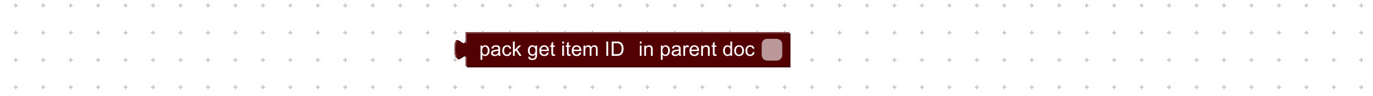

pack get item ID
Retrieve an ID of the currently loaded item from the SCORM pack.
The "in parent doc" checkbox should be enabled if the Verge3D apps's .html file is embedded using iframe.
